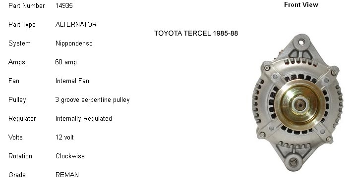

It is still unclear to me which 60 amp ND alternator to start with that will fit the Van's mounting bracket (Boss mount?). What have other done?
Bevan

Here's a wild (at)#S guess. Here's a Lester #14935 that
fits 85-88 Tercels.
[img]cid:7.1.0.9.0.20120815153159.047a6198(at)aeroelectric.com.0[/img]
Oriley's offers this one for about $100. It's frame geometry
appears the same as the B&C L-60 and others popular with
the OBAM aviation market.
http://tinyurl.com/8vfkj66
If you've got the mount, you could go down to the local parts
store and fit check the alternator with the mount and measure
the offset from boss-mount bolt holes to the pulley centerline.
Of course, you need to find a new pulley too.
