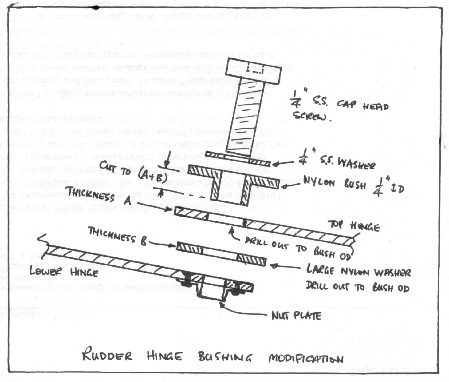

briana(at)xtra.co.nz Guest
Posted: Fri Aug 24, 2012 11:19 am Post subject: Upper Rudder Hinge Reinforcement. |
Sonja, and others,
The upper rudder hinge was recognised as a potential problem a long time ago, in fact while I was still building. I closed off the rudder around and below the hinge to prevent water getting in there, and of course it also prevents any bits falling down inside the rudder.
Some of us modified the rudder hinge to include a nylon bushing. I found a source locally and supplied quite e number to other builders about that time. The hinge is still held together with a 1/4 screw. I used a SS cap screw and can check the tension from time to time using an allen key. I've not found any play in the bearing in nearly 500 hours, and only very occasionally does the cap screw need a little tweak.
I'll attach a sketch of the arrangement, but I suspect it won't travel with the e-mail. If it doesn't go I ail happily send it to anyone who asks.
Brian
