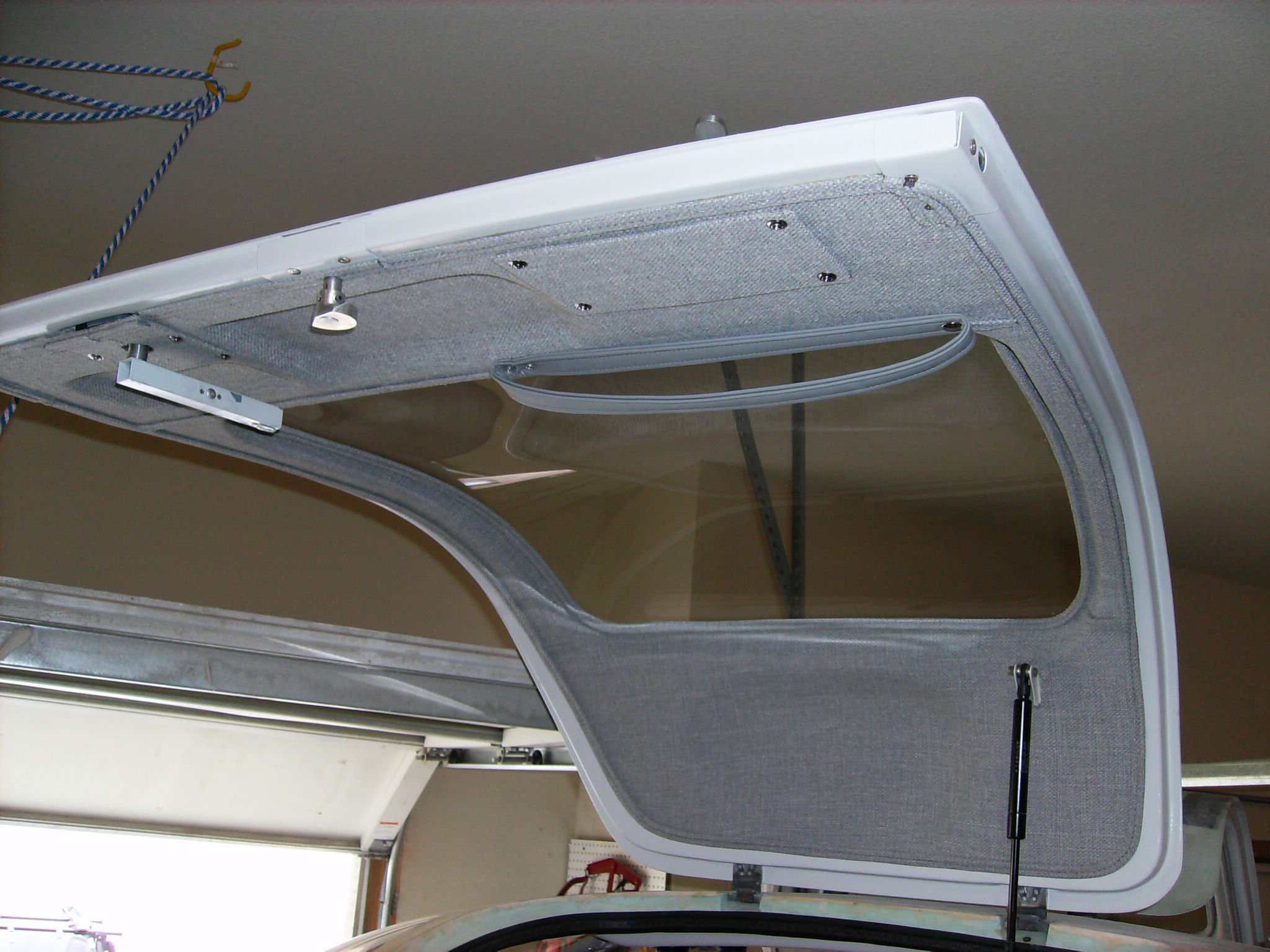

I did the easy way. I used 3/8" self adhesive McMaster seals on the door.
The seal is inside the door lip so you don't do the grinding. I filled in
the hinge area with a piece of rigid foam (held in the RTV) so that the seal
lays on top. Once you have the hinge area filled the seal goes on a just a
couple of minutes. The adhesive is quite adequate. 44 hours (and countless
door opening and closing) and it works well.
Part number: 93085K11
http://www.mcmaster.com/#catalog/118/3471/=jbjp4s
$11 for 20 feet. I tried 1/2" tall seal first, but this was too much and
the door was way hard to close. The 3/8" gets compressed, but not enough to
deform the door.
Carl

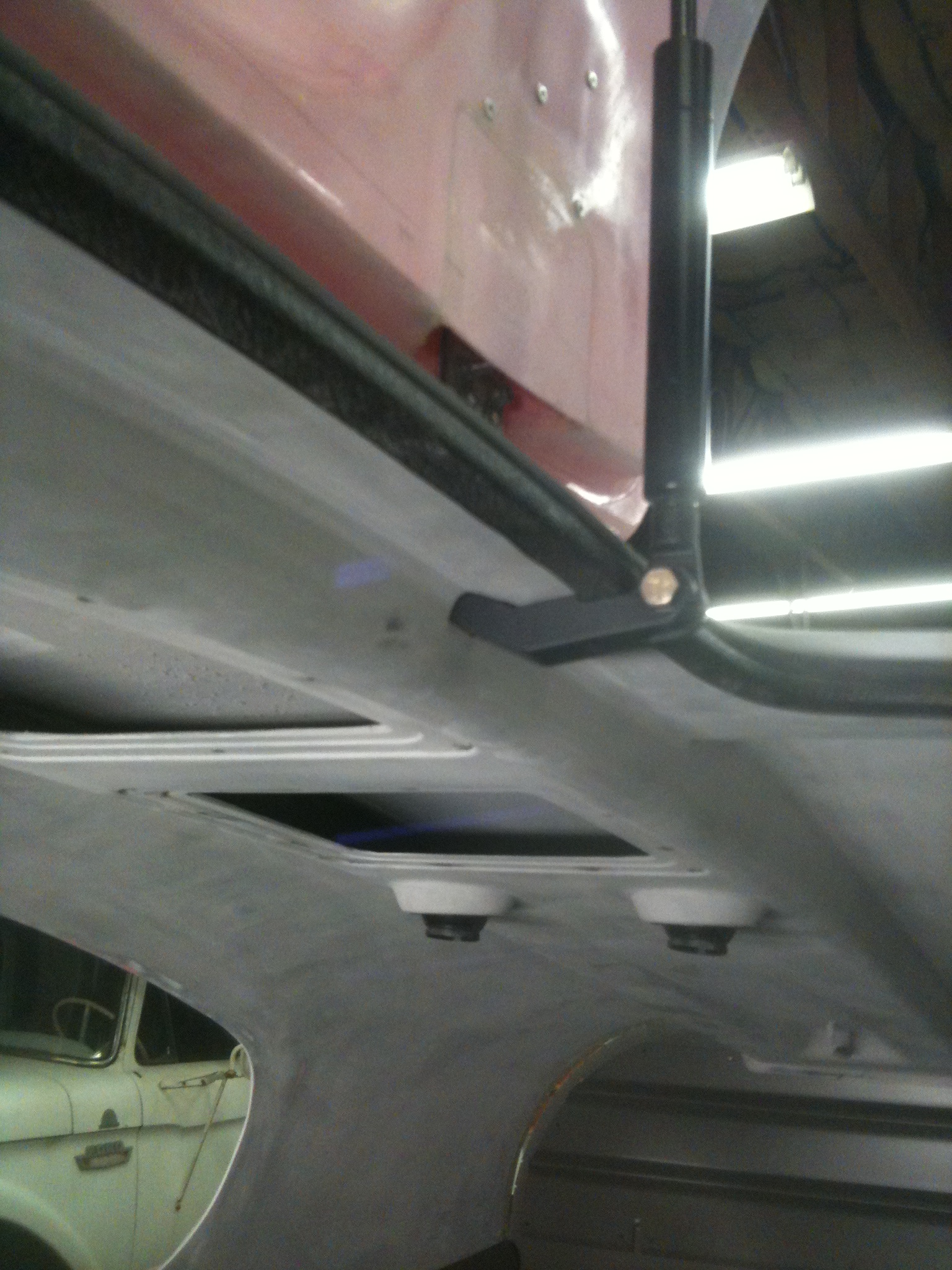

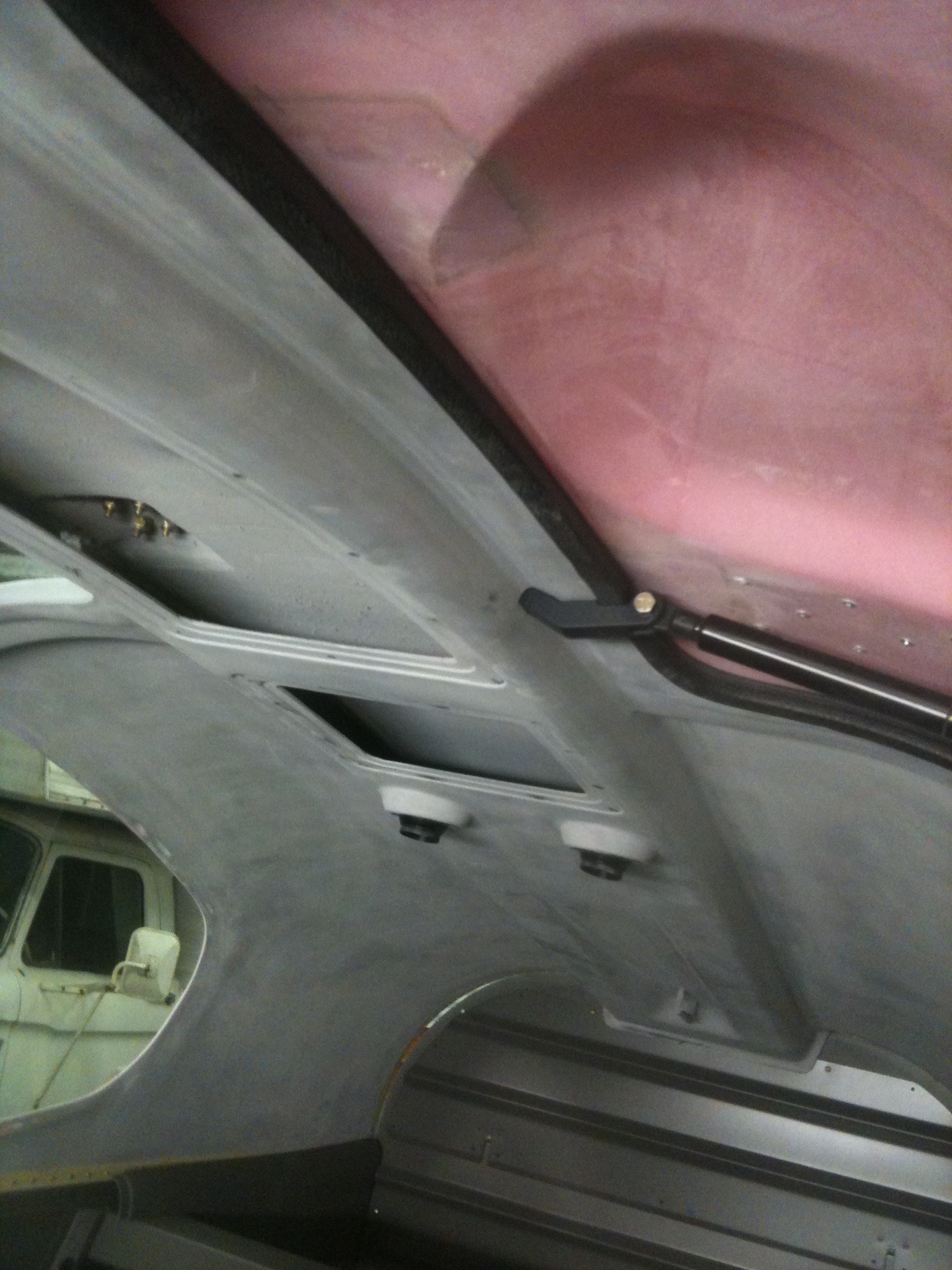

Here is mine with the McmasterCarr seal 1120A311 No leaks at all. I used
nutplates for the hinges even though you could still use nuts.

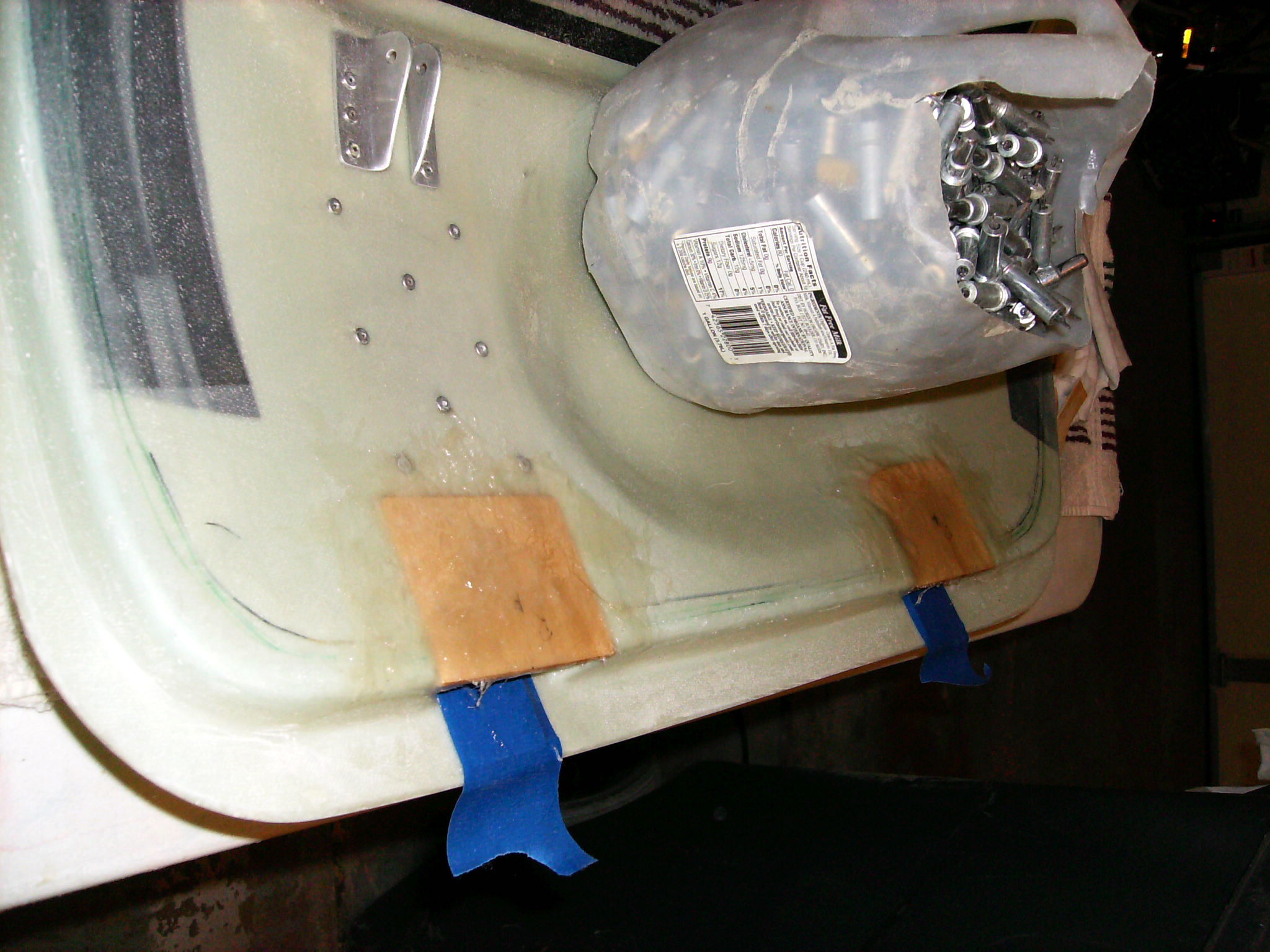

All I did to create a couple of pockets was to epoxy in a couple of balsa wood pieces cut roughly to shape. Then fill with micro and sand. Turned out pretty nice.
Cheers,
Jay
