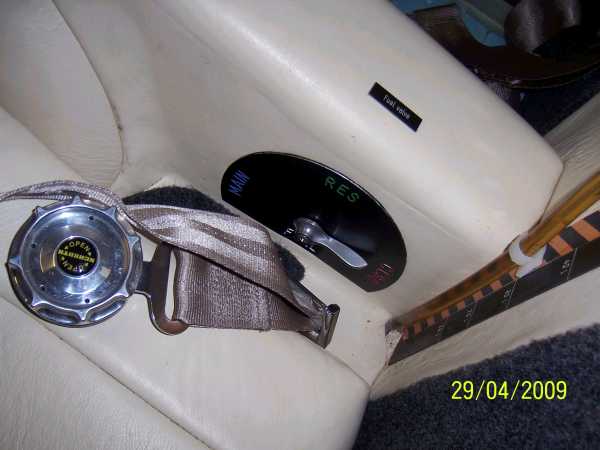

PostPosted: Thu Oct 25, 2012 11:09 am    Post subject: Fuel Selector Extension Reply with quote
Alan,
this mine.
When building, my logic was:
- "MAIN" (open) is blue (one neutral colour and blue skies) and pointing forward (because normally you wanna fly forward!)
- "RES" (reserve) is green (the colour with an inbuild good hope) and pointing upp (because in the case of fuel lack you probably wanna go upp not down)
- "CLSD" (closed) is red (the colour which is alarming) and pointing backwards (because in the case you wanna close your tap you do not wanna fly anymore)
- position downward not possible to select for clarity
Switchable in ½ second.
Backplate is aluminium and carved /colour filled.
Raimo from Finland
OH-XRT
337,40 in an Europa logbook
today 1,5 hours in Messerschmitt BF 109 G with one succesfull landing.
