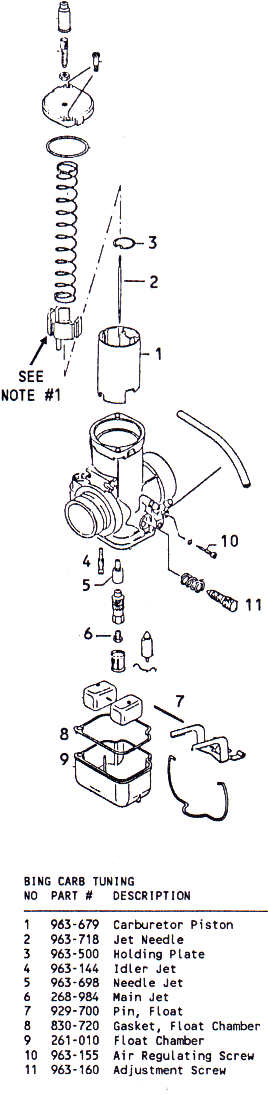

I think you are on the right track with the idle jet. I'm sure you know what you are doing but just to level set check the attached picture to make sure you are looking at the #4 idle jet. This jet has a tiny, tiny orifice and that is probably blocked. I'm surprised they don't get blocked all the time they are so small. Check that jet again and report back. Wink
