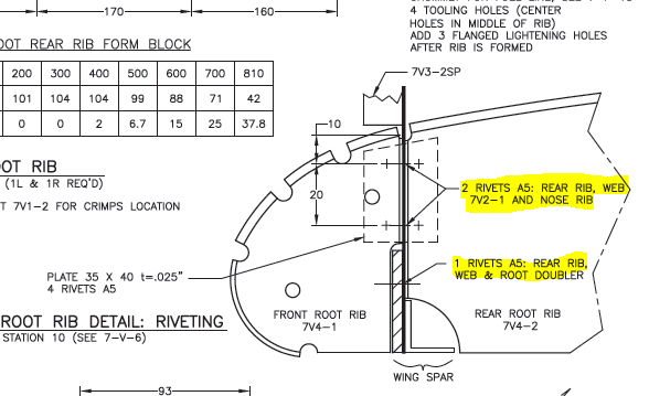

Hi all,
I cannot seem to find on my plans or the updates whether the 3 rivets holding the root ribs 7V4-1 and 2 to the wing spar at station 10 are A5 rivets or A4. Can someone direct me to where the rivet size is called out. The main rib next to it has 6XA5.
Perry

See Attached, 7V4 page.
