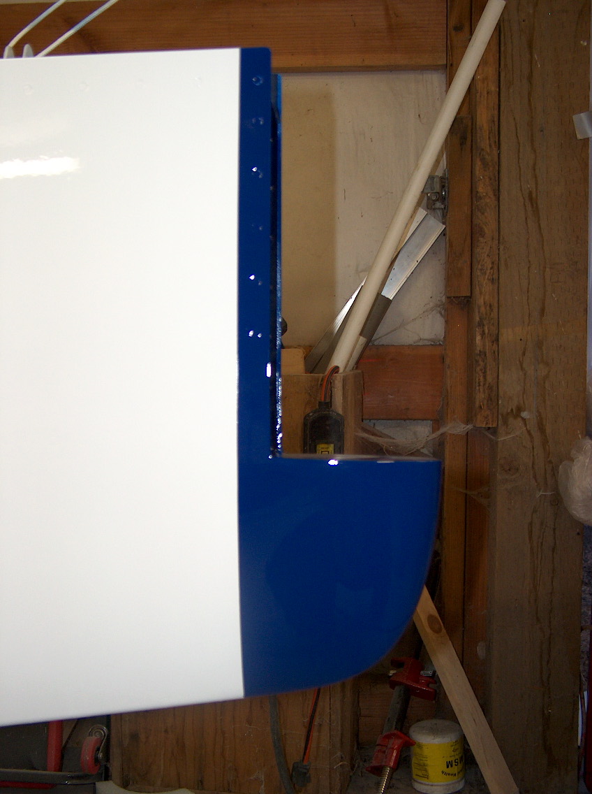

frank.hinde(at)hp.com Guest
Posted: Tue Jun 06, 2006 2:04 pm Post subject: Painting |
Thanks Larry I thought it would be like my first welds...I.e an
unmitigated disaster and waste $1000 in paint, but its awesome to see
the fine result.
I'll attach a pic, don't know if it will work but lets see.
Frank
| | - The Matronics Zenith-List Email Forum - | | | Use the List Feature Navigator to browse the many List utilities available such as the Email Subscriptions page, Archive Search & Download, 7-Day Browse, Chat, FAQ, Photoshare, and much more:

No Frank, I don't know for sure. I would think though with it being gravity
fed, and smaller nozzle orifice implies lower liquid flow, you could get by
with much less than 43psi.
Paul
| Back to top |
Posted: Wed Jun 07, 2006 10:27 am Post subject: Painting |
Actually no you won't...Well "getting away with" is not a term that
works when pinting an airplane. Remember I only got good results by
turning UP the pressure. The 20Oz gun requires (they say) 28psi...I got
marginal to poor results (i.e BAD orange peel) at 28psi and excellent
results at 50 psi.
I tried 55psi this morning but the results did not improve so I will go
back to 50psi from now on.
The touch up gun I also run at 50psi and the results were just stunning.
Frank

Bought the detail gun and indeed it had "HVLP" stamped on the side and
appears identical to the one I am borrowing.
I have not used it yet but have no doubt it will proovide excellent
results.
Frank
