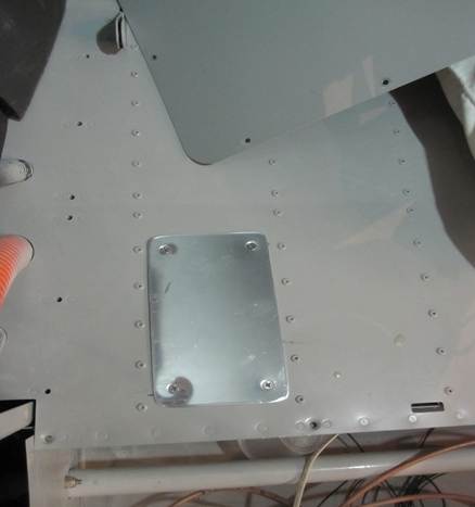

A long story that I'll make short is that the pull strings for my two comm antenna, which are located underneath the rear seats, were removed by the painter.
Since the conduit doesn't go all the way to the floor, I can't use a vacuum to re-run the lines. Also, due to the turns in the conduit I can't push anything past the second turn.
At this point it looks like I'll be drilling out all those blind rivets tonight.
The debate in having with myself is whether or not to just reinstall the blind rivets or go through the time and expense to install nutplates.
For those with comm antenna under your rear seats, have you found a need to get back into those cavities for any reason?
I guess one alternative would be to install access panels over the comment antenna.
Thanks in advance for sharing your opinions!

I put in access panels. Have used one of them already.......

PostPosted: Mon Jan 28, 2013 7:01 am    Post subject: Rear seat access Reply with quote
I was able to fish the cable out, on my initial install, from the bottom
of the plane, but I can understand your situation if the conduit exit
isn't real near the hole for the antenna.
What I would do is install an access plate. I haven't had need
to do that on my plane, but, I did put an access plate on one
bay anyway...more as a storage area than anything. I now carry
some spare parts for small things that I've accumulated over the
years, such as spark plugs, magneto parts, and things like that,
in a little container in the seat bays. That way they
aren't rattling around in the baggage area, getting crushed,
and they are hidden away nicely, but accessible with the removal
of a few screws.
So, it may be an opportunity for you to do a little mod.
To do mine, I had to look at photos to make a narrow slot but
leave enough metal on the sides to allow for installation of an
access plate doubler. I riveted in the doubler, threw in
some nutplates, and then put the strip of metal from the
seat back on top. I did it in about a night I think, in the
hangar.
So all is not lost. I don't think I'd drill out all the rivets.
That would be a lot of work for no great reason. Even worst
case, you could cut a hole, round or oblong, and then cut an
oversized patch that you could rivet on over the hole later.
Under a seat cushion nobody would ever know, and then you'd
have easy access later. Install nutplates and you could
have an access plate that isn't flush, but doesn't need the
doubler.

PostPosted: Mon Jan 28, 2013 7:12 am    Post subject: Rear seat access Reply with quote
Bob,
I wound up drilling all the rivets for my back seats, to add an antenna on one side, and for similar cable situation on other side. It won't take long to drill them, and you won't be able to get the access you need unless you drill virtually all of them. Fortunately they are easy to drill with a sharp drill bit.
I installed access panels to resolve the issue in the future. You may or may not need to get in there again, and access panel with 4 or 6 nutplates is relatively quick and easy to make. If you don't put in access, you will need in there again, if you make the panel, you won't ever have to go there. Just another Murphy's corollary.

PostPosted: Mon Jan 28, 2013 7:14 am    Post subject: Rear seat access Reply with quote
Tim,
I hadn't thought of that, but I like your suggestion. I think that's what I'll do tonight.
Bob

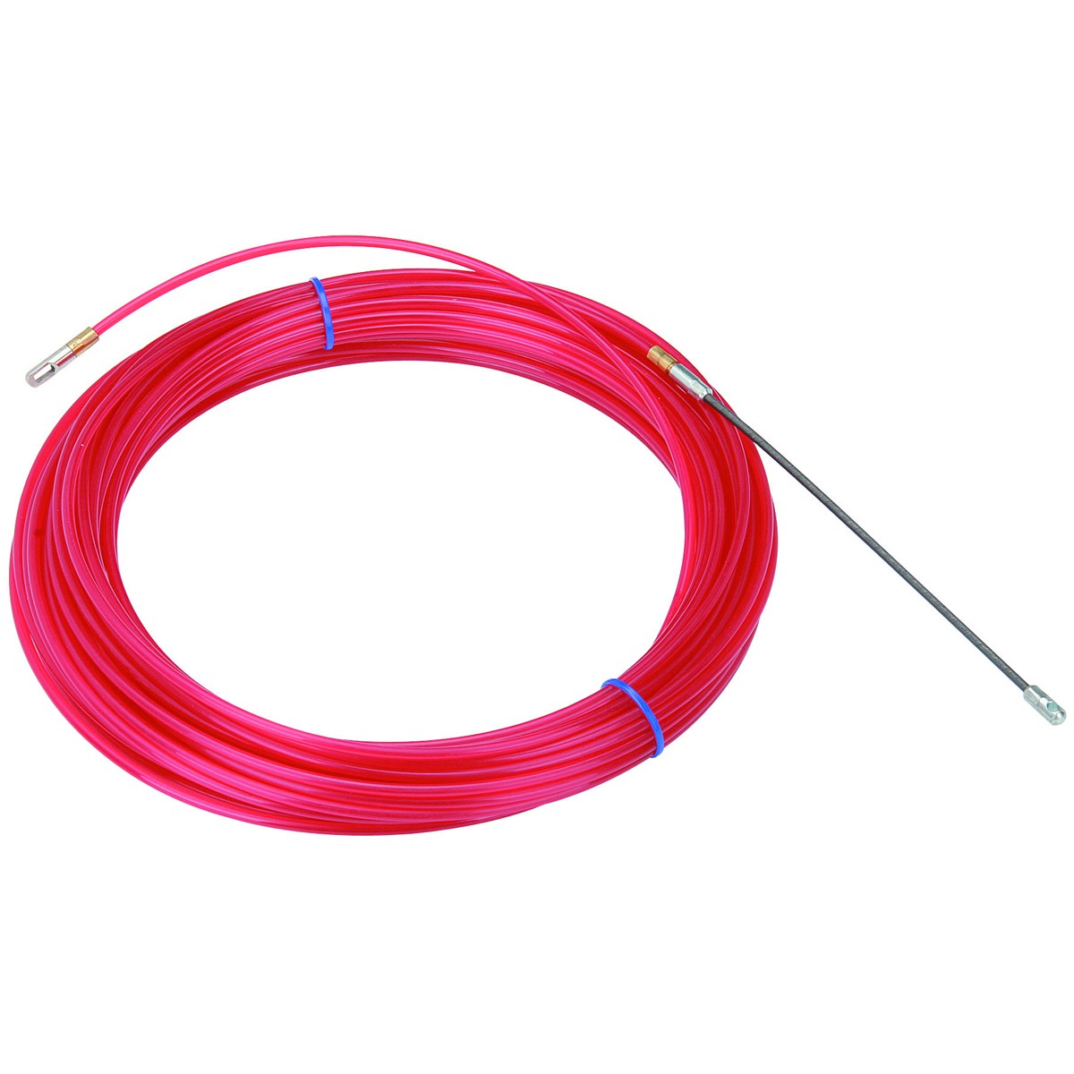

PostPosted: Mon Jan 28, 2013 7:35 am    Post subject: Rear seat access Reply with quote
I made access panels on each side. I used plastic grommets for the coax to
enter from the flap control tubes.
As far as snaking through conduit, I bought a snake from Harbor Freight
(even though I hate that place). It is red plastic with a round metal end.
I could push that through the crazy turns of the conduit.

rleffler
Joined: 05 Nov 2006
Posts: 680
PostPosted: Mon Jan 28, 2013 7:59 am    Post subject: Rear seat access Reply with quote
Yep, having done audio and data wiring for over twenty years, I know most of the tricks.
There is about a two inch gap between the end of the conduit and the antenna mounting hole. I had hoped the string was just laying on the floor and I could suck if out. But that doesn't appear to be the case.
Installing an access plate is a good idea regardless, so I just spend some time installing one now instead of later when I need to make a repair
The corrugated conduit, doesn't work well wish any of my fish tapes. Although none of mine are like the on Sean described.

Good luck.....
Rene' Felker
N423CF
801-721-6080
Bob Leffler

Bob,
My conduit is corrugated blue stuff. The fish tape I have works well. If
you want I can ship to you.
40936
RV-10 SB N801VR Flying
780 Hours
SuperSTOL 60 hours
rleffler
Joined: 05 Nov 2006
Posts: 680
PostPosted: Mon Jan 28, 2013 9:24 am    Post subject: Re: Rear seat access Reply with quote
Strasnuts wrote:
Bob,
If you are talking about this one, I may swing by HF on the way home tonight. It looks like it's less expensive to purchase than ship.
My only opportunity is that the conduit comes out of the rib a few inches forward of the hole for the antenna connector. The question will be if I can grab it blindly through the hole? But it may be worth the try.
bob

PostPosted: Mon Jan 28, 2013 10:10 am    Post subject: Rear seat access Reply with quote
That's the one

PostPosted: Mon Jan 28, 2013 6:25 pm    Post subject: Rear seat access Reply with quote
Update:
I picked up the fish tape that Sean recommended. The head was indeed large enough to get through the two 90 degree bends in the corrugated conduit. I still couldn’t get the end through the 1/2" opening for the antenna on the bottom of the fuselage. I ended up making a small access door, which probably should be there anyways to make troubleshooting antenna issues easier down the road.
Thanks for everyone's opinions!
Bob
