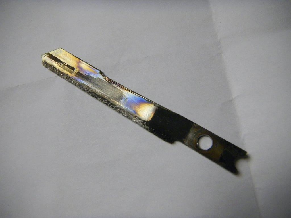

Guys, I started trimming the cabin top today and made 2 discoveries.  1) as others have found normal jig saw blades dull incredibly quickly.  2) I also tried a carbide jig saw blade I purchased years ago to cut ceramic tile.  This blade was mounted in my Makita jig saw and worked great.  I completed all the rough trimming in probably a 1/2 hour, and with little dust compared to a rotary tool.
Unfortunately I have no idea where I purchased this blade now but if you can find one, give it a try.

What grit of carbide blade did you find worked best for you?

William,  I don't have any idea what grit it is.  I attached a photo which should help.  I would say that the grit could have been more coarse which would have made it cut even faster.  The blade is pretty beat up now.  I was in a machine shop/tool place yesterday and they had similar blades, so they must be available.  Certainlt a tile installtion place would know where to get them.
Good luck,  Rick

I just purchased a carbide blade at a menards ( similar to lowes). It was manufactured by bosch and it said 30 grit, part number is U30RF1. It really did work well for initial trimming, thanks for the tip.
