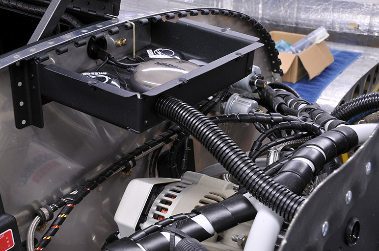

Someone on the RV-10 list shared a photo of their GPS shelf mounted FWF that had 4+ GPS antenna mounted. I recall the shelf was painted black and connected the firewall with the motor mount? Can the owner share the photo again with the group? I need something similar for my 8A and cannot locate the post.

Here's the post in the forums with a bunch of options including the one
you are referring to.
http://forums.matronics.com/viewtopic.php?p=392689#392689

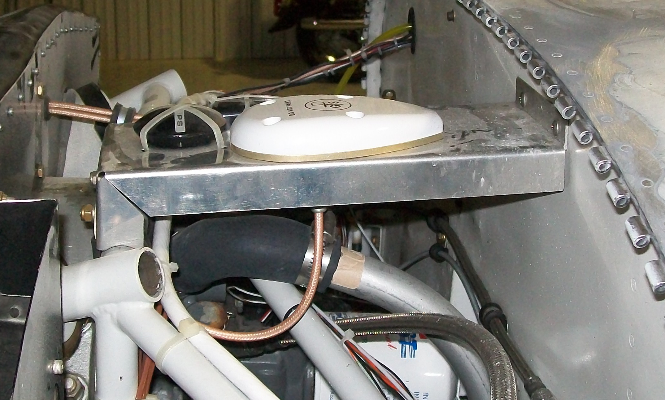

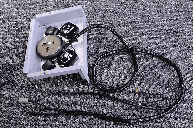

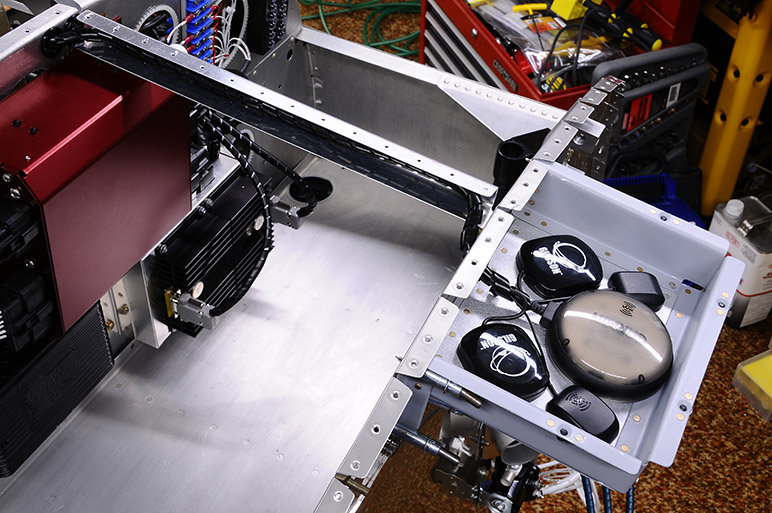

PostPosted: Tue Mar 12, 2013 3:58 pm    Post subject: GPS Shelf FWF Reply with quote
Here is my solution.
Jim Combs
N312F - Flying 460+ Hours
On Tue, Mar 12, 2013 at 2:55 PM, Robin Marks <robin(at)painttheweb.com (robin(at)painttheweb.com)> wrote:

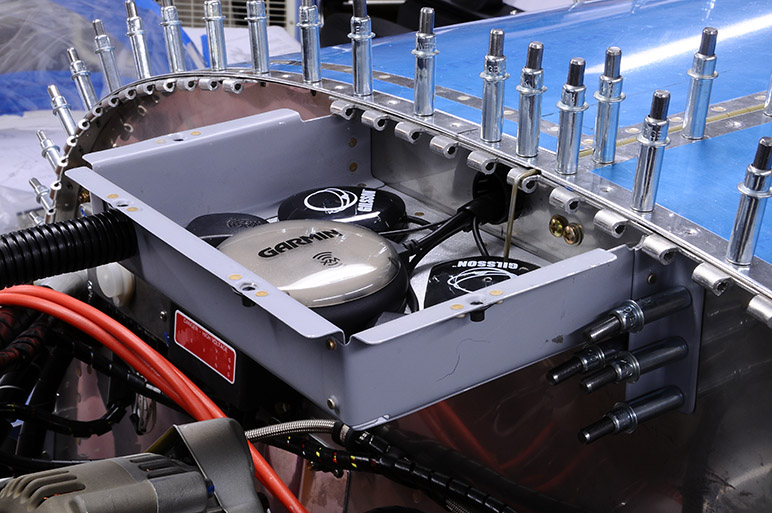

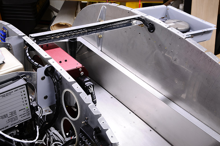

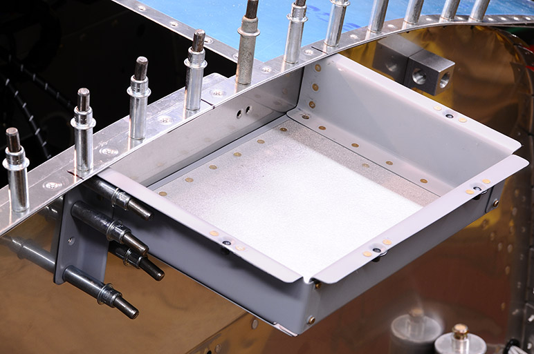

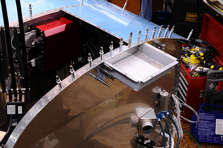

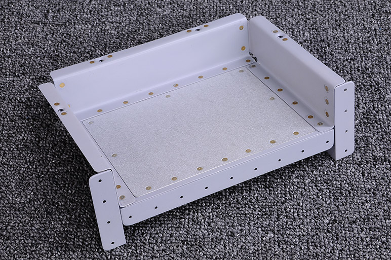

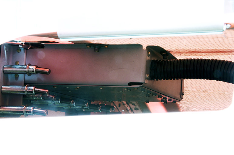

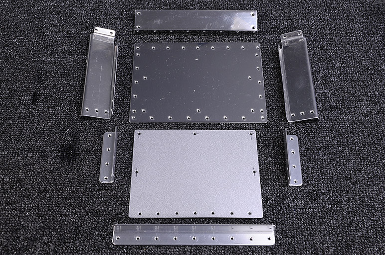

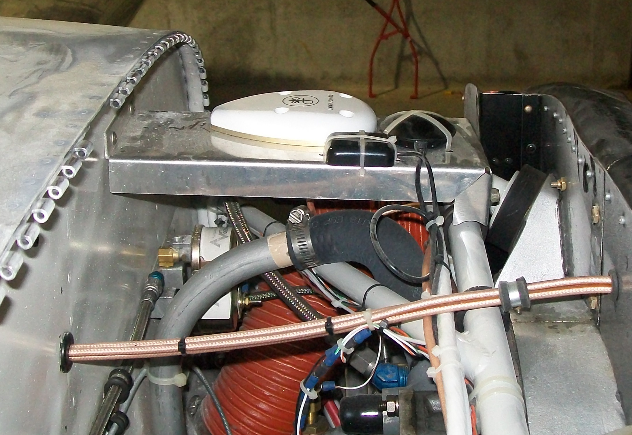

Hi Robin,
Here are some pictures of how I did the GPS antenna installations on my RV-8. Works great. Blast tubes keeps them cool. No unsightly pucks on the dash!
Matt
