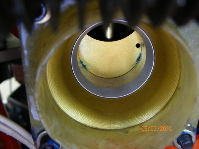

Yes, it has worked out well for me. When I first looked at the TBI-40
at Oshkosh in 2009, Paul (from Rotec) told me that the -40 would
probably be a bit too much throat area for my 2200 cc Jabiru engine,
and that I might have to restrain the throttle opening by 1/4" or so.
This is because the TBI-40 was originally designed for their 2800 cc
engine, and therefore the throttle opening needed to be larger for
that size engine. I did this for a while, but later on, I made a
sleeve that is a push fit into the air inlet...before the slide
throttle. Because that area of the TBI is slightly tapered, it was
fairly simple to turn out a sleeve on my lathe that would push into
the air inlet, and could not be sucked further into the
airstream...works great, and I also have a sleeve that is 35 mm
inside diameter that I made at the same time, for testing purposes.
When I got the TBI, I got the round rear housing, to slide right into
where my Bing was, but in building various intake manifolds, I
decided to get the -3 rear housing, the one with 4 bolts, so I could
more easily adapt to the manifolds I was designing.
I noticed that Rotec was selling the 32 mm's for VW, etc. If you get
too large a carb/TBI, the air speed through the device will not allow
proper fuel atomization, thus the reason for making the smaller units.
Here is a shot of the sleeve in place, as viewed from the air inlet end:
