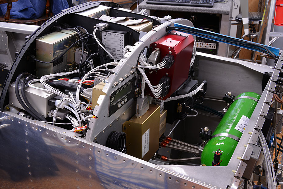

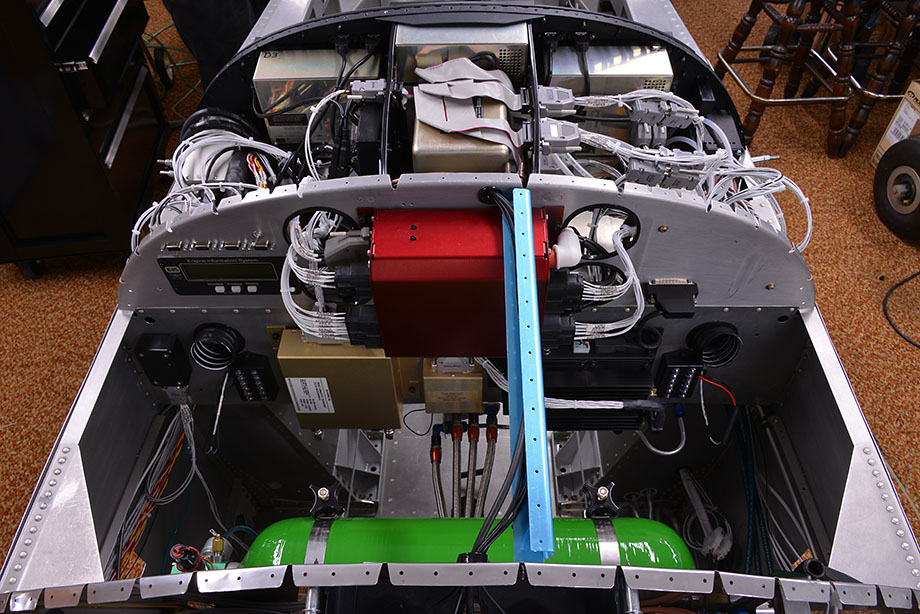

PostPosted: Wed May 01, 2013 11:01 am    Post subject: RV-10 Electric system Reply with quote
At 11:12 AM 5/1/2013 Wednesday, you wrote:
If there's one thing I don't regret when I bought my avionics and did my panel early, it was the VP-200. It's a shame it was discontinued.
-Sean #40303 (wrapping up FWF)
On 5/1/13 12:43 PM, Robin Marks wrote:
>I built two planes w/o using Vertical Power. If I ever build another I hope I don't make the same mistake a third time.
>Robin
I couldn't agree more. I have a VP-200 system in the RV-8 and in the RV-6 and I couldn't imagine not flying with one. I've got well over 300 hours on the two systems without a single issue. The electrical automation that the VP-200 brings to the cockpit is outstanding. The simplification of wiring can't be understated. I am also very disappointed that Vertical Power hasn't stayed focused on what they are really good at - electronically controlled aircraft electrical systems. Hopefully VP will come out with something more akin to the 200 in the future.
Matt Dralle
RV-8 #82880 N998RV "Ruby Vixen"
http://www.mattsrv8.com - Matt's Complete RV-8 Construction Log
http://www.mattsrv8.com/Mishap - Landing Mishap Rebuild Log
Status: 172+ Hours TTSN - Rebuilding Fuselage After Landing Mishap...
RV-6 #20916 N360EM "The Flyer"
http://www.mattsrv6.com - Matt's RV-6 Revitalization Log
Status: 150+ Hours Since Purchase - Upgrades Complete; Now In Full Flyer Mode
