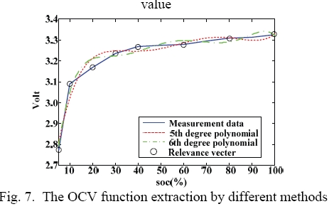

The numbers for a drop-in lithium battery should be just
FINE with similar CHARGE voltages . . . the MAINTENANCE
voltage will no doubt be different. This graph taken from
a learned treatise on Li batteries
[img]cid:.0[/img]
Suggests a room temperature open circuit voltage
on the order of 3.35 volts per cell or 13.4 volts
for an array of 4 cells. This means that the
Li-battery 'maintainer' needs to be on the order
of 13.5 volts . . . probably not too high for a
lead-acid battery either.
