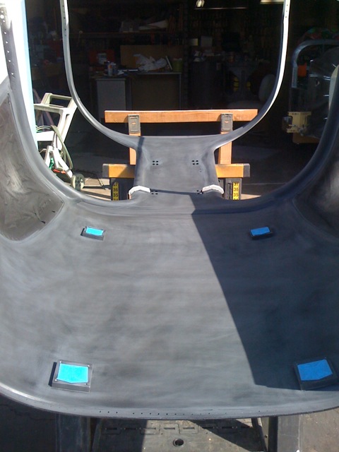

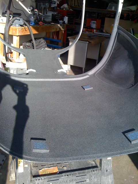

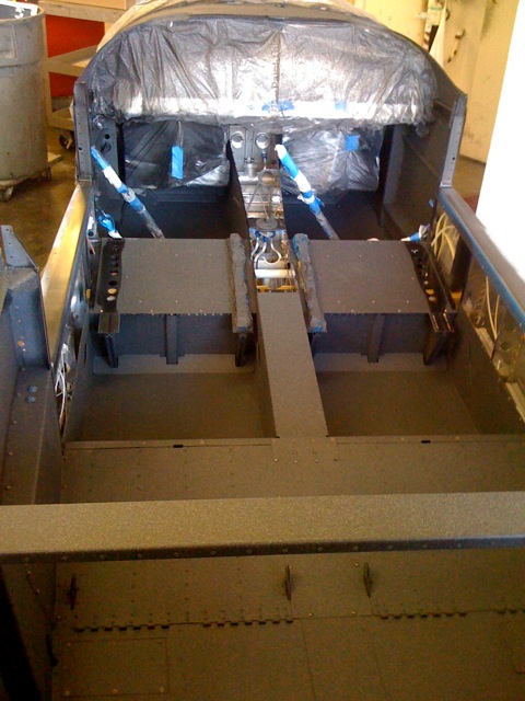

I suggest you get at it before you install the rudder pedals, upper forward fuselage and the cabin top, as access to areas around the forward area of the floor is much easier at that point. Also, get the cabin top while it's off the plane and you can shoot down at it outside. I used a spatter paint called Zolatone, on a base of Loehle's black highbuild primer with the intention of keeping things light and not installing any upholstery anywhere other than the seats.
