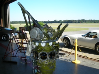

While the Tach drive and the air start distributor share a spline drive inside the accessory case. They are not bolted to the same port on the accessory case. It does sit anterior to the "octopus" though.
Doc
Sent from my iPad

And it has a different drive ratio.
George
