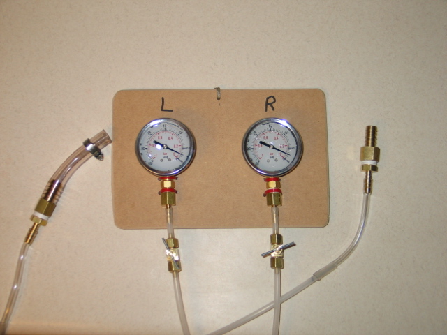

PostPosted: Wed Jun 26, 2013 11:21 am    Post subject: Re: carb synch hose sizes Reply with quote
Here's an older picture, but it gets the point across and this works very well. I would use regular vacuum lines and not the clear plastic. The plastic does work.

PostPosted: Wed Jun 26, 2013 3:57 pm    Post subject: Re: carb synch hose sizes Reply with quote
Thanks for the picture. Makes sense to me now. How close are you able to get the difference between the carbs? Also, do you make the adjustments to a running engine or do you shut off between adjustments?

PostPosted: Thu Jun 27, 2013 5:26 am    Post subject: Re: carb synch hose sizes Reply with quote
I can get the needles dead on for idle and the high rpm settings. Once you do it a few times it doesn't take long. If you do it each annual or 100 hrs. it's a piece of cake. I always do a running engine. I wear goggles and ear muffs and I give that prop a wide berth. The wheels are always chocked and someone is in the cockpit.
