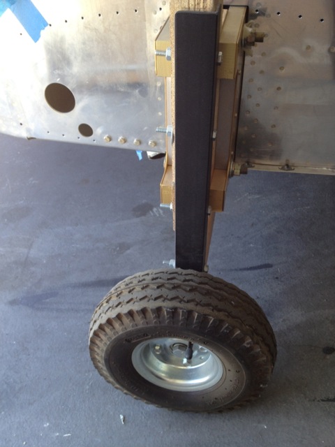

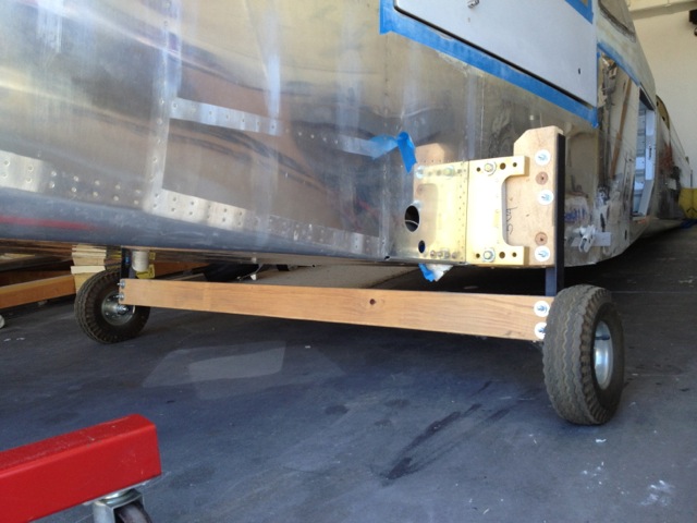

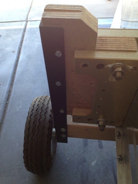

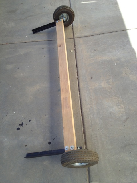

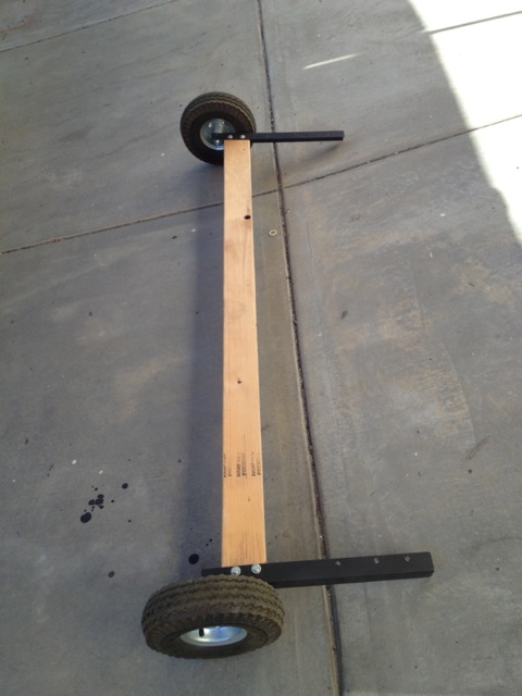

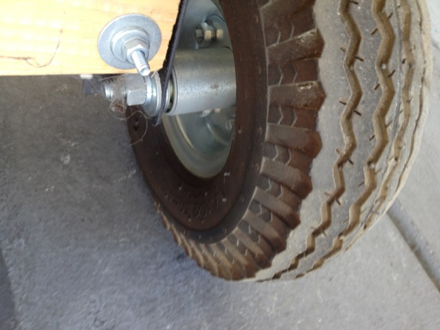

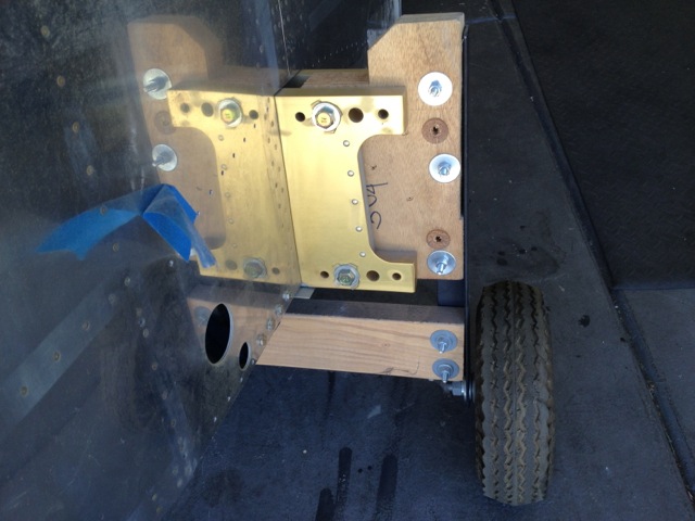

Wanted to share this for those that might be ready for fuselage mobility. Attached photos show a simple and inexpensive way to have a mobile yet secure fuselage structure as you build.
I have gotten in and out of the fuselage hundreds of times and moved it everywhere from front yard to backwards in the garage and it worked great. Didn’t want to share it with the group
until I was sure it worked for me..... It did, and I’d do it again. Use air tires, not hardened rubber.
Mine just moved up in the world to permanent gear. Not it’s first time either as I’ve already fit and finished legs, fairings, and pants some time ago. At that time this jig came off, then when
complete, went right back on. It is much easier to work on the fuselage when down low then when on its gear. Hope this helps some of you fellow builders...….

I did this same thing. After I was up on the landing gear I donated the
set to another builder. Hope it is still making the rounds.
Works really well and the fuselage is low to the ground. Makes getting the
top fitted and access to the top portion really easy.
