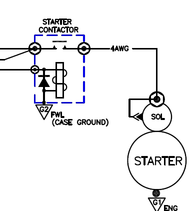

PostPosted: Fri Jul 05, 2013 8:32 am    Post subject: solenoid wiring question Reply with quote
Re figure 5 of Bob's diagram of adding a starter contactor upstream of the original starter solenoid:
Is there any reason not to wire the fat wire to the starter side of the old original starter solenoid, with a jumper from the fat wire terminal back to the old starter solenoid energizer terminal.
The point would be to eliminate the high current having to flow through the old starter solenoid disc, since the high current is being controlled by the new upstream starter contactor.
Thanks, Skip Simpson

I agree. It se ems pointless to have 2 solenoids operating at the
same time. The other issue is that I believe the Subaru solenoid
moves the gear before the contactor part puts juice to the motor
brushes. An aircraft type contactor would do both at the same time
rather than sequentially. Have not dismantled one so I may be in error.
None of applications of an external contactor
proposed for modern starters "bypasses" functionality
of the built in solenoid/contactor. The
starter's built in solenoids do engage the pinion
gear before closing electrical connection for
the starter motor.
Variants to select from when using these modern
starters causes the builder to decide whether
the built in contactor is energized by the panel
mounted, START switch -OR- energized through a more
robust device.

B&C adopted the philosophy of jumpering the starter
solenoid coil right to the fat-wire terminal on
the starter . . . and controlling power to the
starter though a modern, starter contactor WITH
built in coil suppression diode. The external contactor's
inrush demands on the start switch are a small fraction
of that for direct control.

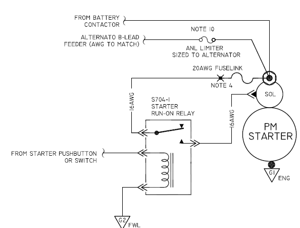

This philosophy posed a new problem when PM motor
starters began to show up on the airplane. PM motors
have a pronounced counter-emf during spin-down after
the power is removed. This would delay disengagement
of the pinion gear and was commonly called "starter
run on" . . . in fact it was better called "delayed
disengagement".
Starters with wound fields (B&C and some others)
do not suffer this indignity and function well with
the engagement solenoid jumpered directly to the
starter's fat-wire terminal.
In ANY case, the builder's design goals should
include providing a source of solenoid engagement
power that (1) is supplied through a low impedance
source (short and fatter than usual wires) and
(2) avoid running this power through the panel
mounted start switch.
If the starter is a PM version, the builder can
take advantage of the "I" terminal on many modern
starter cotactors and use it to SUPPLY current
to the engagement solenoid. This provides for
instant removal of coil power when the starter
switch is opened and prevents 'delayed disengagement'.
In this case, the builder would do well to have
diode coil suppression on BOTH the external contactor
coil AND the solenoid/contactor coil on the
starter.

PostPosted: Fri Jul 05, 2013 8:38 am    Post subject: solenoid wiring question Reply with quote
That would engage the starter motor before the solenoid engages the flywheel with the starter drive gear. It could cause a mess!
B2
From: owner-aeroelectric-list-server(at)matronics.com [mailto:owner-aeroelectric-list-server(at)matronics.com] On Behalf Of cardinalnsb
Sent: Friday, July 05, 2013 12:28 PM
To: AeroElectric-List Digest Server
Subject: AeroElectric-List: solenoid wiring question

PostPosted: Fri Jul 05, 2013 9:50 am    Post subject: solenoid wiring question Reply with quote
Just so I'm clear, what "figure 5" are you referring to?
Wired like this?
[img]cid:.0[/img]
It would be helpful if you would sketch your proposed
change, scan and attach to your email.
By 'original' I presume you're talking about the
one built onto the starter. I'm not sure of "the point".

The reason for the upstream contactor is to buffer
the current draw on the starter engage switch. An alternative
method calls for a relay wired thusly.
[img]cid:.1[/img]
Which ever way you decide to do it, the singular design
goal is to reduce stresses on the starter engage switch
on the panel.
  the starter motor.
  robust device.
  There is a problem to be solved when the panel
  mounted starter control is used to energize the
  starter's built in contactor. Unlike legacy
  'starter solenoids' controlling starters with
  Bendix drives, the modern pinion engagement
  solenoids have a very high coil current demand
  during the first few milliseconds of being
  energized. See: http://tinyurl.com/op5cs2g
  Failure to recognize this difference in
  solenoid/contator performance caused a
  kerfuffle over burned start switch contacts
  on the ACS-510 key swicch (clone of legacy
  Bendix/Gerdes). ACS now sells a diode with two
  terminals applied.
Emacs!
  A critical need to install this diode across the
  starter contactor engagement coil arose from the
  alarming rate at which start contacts in the key
  switch were destroyed by overstress when the legacy
  starter/external contactor combo was replaced with
  a light weight version with combination solenoid/
  contactors. Many cars suffered similar failure modes
  in their key-start switches.
  SB92-01 from ACS originally place thier diode across
  the switch contacts . . . wrong place. It was corrected
  in a subsequent revision. See http://tinyurl.com/nva2xdy
  disengagement".
  starter.
