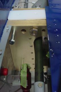

I installed a small fuel filter in each wing root. They have AN-6 fittings on each end and have stainless filters (I think mine are 40 micron). I only have one photo and it was taken for a different reason, but I'll post it. I'll also post a web photo of the filter. Here is a link to where I bought them:
http://www.summitracing.com/parts/sum-230101/overview/
It is not a problem to get them out. I mounted them at a 45ΒΊ angle. The tank line first goes up almost to the skin, and turns to attach on the top of the filter. The bottom of the filter is connected straight to the line from Van's plans. Even with full tanks, there is no leakage (maybe if I did it with absolutely full tanks it might). The only leakage is the tiny amount that is actually inside the filter. I simply drop down the front half on the lower wing root skin and put a catch basin underneath to catch the small bit of fuel.
John
