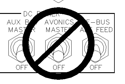

A similar question for an avionics bus, while I know this is not needed to protect the avionics, I have been advised it is a good idea so that there is minimal battery drain while starting the plane, after start you flip the avionics master to turn on the majority of the avionics.
. . . old flyer's prophylactic having roots in a time
when radios were fitted with vacuum tubes and
electro-mechanical power supplies. Also a time when
airplanes were cranked with rather soggy, flooded, lead-
acid batteries.
[img]cid:.0[/img]
The avionics master (like the Kettering spark
system) is a feature we can appreciate for its
value at the time . . . but happily discarded
when that value diminishes and gets replaced by
something better. See http://tinyurl.com/jn6gykz
