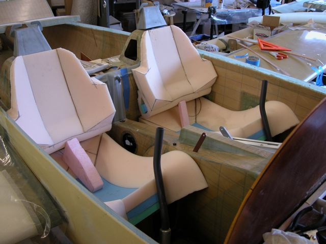

I had used Temperfoam with all 3 grades of hardness for the seat cushions, and I had repositioned the upper seatbelt attachment points to the upper fuselage just behind the canopy. The original seatbelt point is below the pilot's shoulder level and well back, so that there is always some slack left, and it will increase the likelihood of spinal injury.

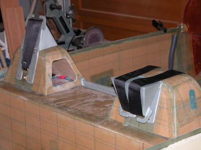

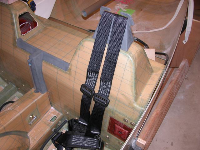

Jeremy...as you're no doubt aware, the standard shoulder belt on the Europa is at or below shoulder height and is apt to contribute to spinal compression in a hard landing. I've raised mine w/ a hinged riser as shown in the attached photos...I've stress-tested them to 15 Gs w/ no collapse or deformation...the hinge allows for the normal "sitting on the raised seat back" method for entering and exiting a XS mono...no change in shoulder belt attach point.
The last photo shows my layers of blue and green Temperfoam, augmented w/ regular upholstery foam wedges...note the ends of the lumbar support visable at the seat back...backs are propped in place w/ blocks of pink styrofoam.
Fred
