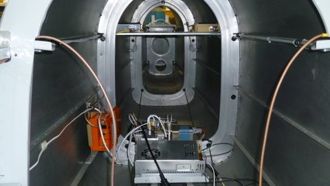

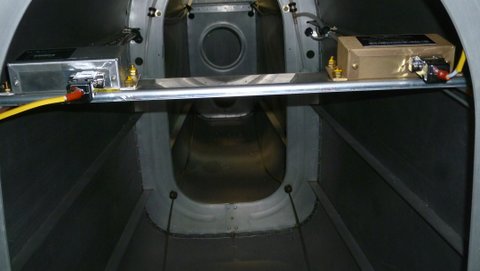

Stan,
Here is a photo of my mounting of dual AHRS boxes on a bracket spanning the longerons aft of the rear baggage compartment.  Notice that the AHRS units are inclined at the same angle as the panel.  You can also see the brass hardware using jam nuts to lock the hardware and a dab of indicating lacquer on each.  The bracket is attached to the longerons with SS hardware.  Although the SS hardware is slightly magnetic as indicated by testing with a permanent magnet they don't appear to affect the indication or operation of the AHRS units.
Chris Stone
RV-8
