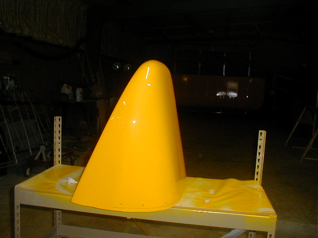

Hey gang lets talk nose cones. I am not real happy with mine as well as others. I know the fine folks at TNK do their best with these and for the most part they are holding up but mine is like paper thin. It will crack if you look at it funny. Wonder if Uncle Craig would consider making us some carbon fiber nose cones with perhaps some special reinforcements where we might like to mount say an antenna or something elese?

"Hey gang lets talk nose cones"
Hey Paul,
Your right on the nose. I had to cut my original nose from front to back on the bottom and open it up 1/2 " then reglass it just to get it to fit over the cage. That still didn't do the trick and nothing would. I asked TNK for a replacement and got it lickety split no problem.
I haven't had a chance to check the fit yet but you are right it is much lighter which can be a good thing. It appears to be more symetrical also.
It's not hard at all to slap a little glass mat and epoxy inside where you might want it - at the expense of extra weight.
Again your right about Uncle Craig. I'd like to see him make noses for Kolb.
What I'd like to know is how to attach a skid under them to insure us complete beginers against an expensive and time consuming repair from even the slightest nose dinging.
Maybe a vertical partition inside front to back. Maybe Uncle C. would know how to do that and if it would work.
By the way your prop spacer is perfect! I decided not to use one since I have flaperons instead of normal flaps and 5" of clearance all around. I hope it doesn't mean a lot of extra noise.

Paul, Nice looking nose cone. Why not just get a yard of BID (bidirectional weave fiberglass) a quart kit of an epoxy you like (EZ Poxy, AeroPoxy and MGS are all good), and put reinforcements where you want them? Just prep the area by sanding, wet out your reinforcement, put it in place and squeegee down a piece of peel ply so the edges don't curl. You can also encapsulate any metal of phenolic plates so you have a solid area to attach things. Look on the LongEZ and Cozy builder's sites and you'll find all sorts of clever ways to do what you want.
The problem with carbon fiber is that it's very pricey, is extremely fragile if only used to its design specs, and takes an autoclave bake to really get those properties of light weight and strength. For the homebuilder, there's no advantage of carbonfiber over "S" glass.
Rick

Lancair builder and all around good guy here - and here's my 2 cents...
Rick is right. Carbon fiber is strong as hell and very very pricey AND there are some disadvantages to it as well - believe it or not. E or S glass, especially the lighter weights, are the easiest to work with. Carbon fiber frays and it needs constant pressure during the cure due to the stiffness, it WILL bow, even saturated with resin, mostly on the outside of an L shape. On the inside of an L shape it is much better.
For the application you are discussing, simple E-glass or S-glass is the way to go. Don't cake on too much resin because it does compromise strength and weight to add un-necessary resin.
I clean, sand 40-80 grit, clean, and clean (acetone or MEK) the surface first, paint a thin layer of resin where I want the glass. On a table, I put a layer of plastic, then E-glass - 1 or 2 layers and a layer of peel ply on top (but this is not always necessary - just DON'T forget to put it on the TOP, not the bottom or you will have NO bond) - and then another layer of plastic. Use a long screw from Home depot with just the threads, no nuts, use just enough pressure to remove excess resin and air bubbles like a baby rolling pin- if the cloth turns white, you took out too much resin. The groves in the screw will allow just enough resin to remain.
Then, mark the top of the plastic sandwich with a sharpie and a ruler - say a 2 inch strip or whatever you want. Cut both sides of the sandwhich. Carefully remove JUST the bottom layer of plastic (NOT the peel ply side). The remaining sandwhich will retain the shape of your cut. Lay down the bare saturated glass side to the part you painted. Gently push out any air bubbles and remove the TOP layer of plastic which is directly over the peel ply layer which you are going to leave. Get it as perfect as you want and remove drips with a rag of acetone but don't mess up your edges. You can even use a small strip of duct tape over the edges to keep them down while curing. When cured, remove the peel ply and you'll have one hell of a nice looking strong as hell layup without too much resin.
Lancair did a bunch of testing a few years back before they would only talk to millionaires - and found out that too much resin was NOT as strong as this procedure. I see lots of people paint resin and put in dry glass, paint more resin, more dry glass, paint more resin, and more dry glass until it's all saturated way too much and resin is running out all over hell and creation. PLUS when you finish that way, not only is the strength compromised, it looks like a crap and is such a sloppy lay up.
Anyway, that's my 2 cents but do whatever you want - after all - it is EXPERIMENTAL meaning you can do JUST THAT!!!
Have a great day and good luck!

I had to do some minor cutting and rewelding on my front frame to get a good fit with the nose cone. I think the problem was on the lower right and left corners of the cage.
I'm also building a support structure out from the front cage inside the cone to attach a combination skid, pull handle and tie down fitting. I should have it done in a few weeks and will send some pictures if it turns out O.K. The fitting will attach thru two holes on the bottom of the cone.
