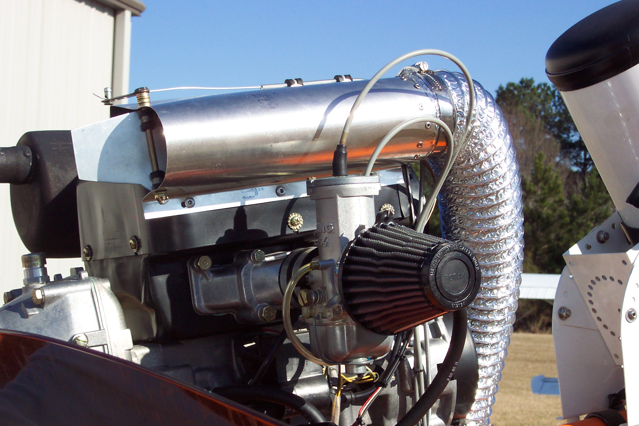

So my Rotax 447 Bing 54 carb Firestar has been at another airport for 2 days now... the reason...
When I apply full power and take off about 30 seconds into the climb I loose engine power. I can run at partial throttle and get back and land, but the full throttle will kill it.
I have a couple theories...
One is a bad/wrong size main jet...
but I took it apart and verified it was clean and the right size (it's a 165) and today it was an internationally standard day temp wise (65F) at sea level.
My other thought is maybe the carb is not vertical and tilted too far back during the climb and therefore the bowl level is tilted and uncovering the jet?
I'll attach a picture of the carb...
Any other thoughts on what it may be...
Ground run is good, I adjusted the clip to #2 from top and re tuned the carb on the ground.
-Erik
