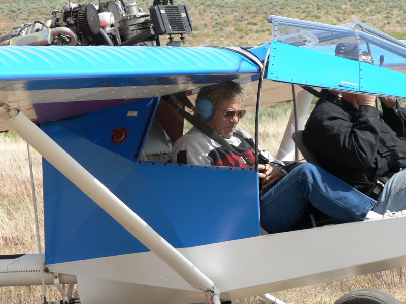

Posted: Fri Mar 23, 2007 1:40 pm Post subject: Re: Leading edge deformation |
Was this the picture ???
Gotta Fly...
Mike & "Jaz" in MN
| Description: |
| Filesize: |
34.72 KB |
| Viewed: |
356 Time(s) |

mdnanwelch7(at)hotmail.co Guest
Posted: Fri Mar 23, 2007 3:32 pm Post subject: Leading edge deformation |
To Mike and Jaz,
Wow!! Yes, that is the picture I was referring to. Boy, it sure
doesn't look near as bad as I remember. Plus, the shadowing excetuates the
depressions, making them look a little worse than they obviously are. (Which
aren't that bad after all.)
Thanks, Mike, for doing the research and helping me see that this
situation really isn't an issue, at all. Livin' and learnin'
...... Thanks for you guy's help! Mike in SW Utah
