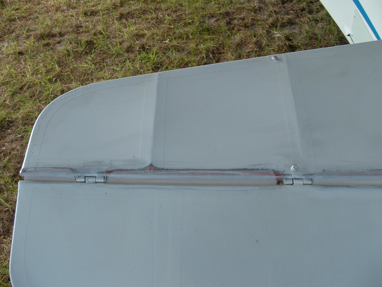

Hi Kirk,I made my own gap seals on my kitfox 4 and they work great,after
talking with the group I decided to do mine with 3" wide pinking tape and
repaint my fabric on the tail,just a little poly tac and some pinking
fabric and it makes a nice looking pro job.....heres a pic.....
hopes it helps you out....MarkN61AC

n85ae
Joined: 14 Mar 2007 Posts: 403
Posted: Thu Mar 29, 2007 5:58 am Post subject: Re: Gap seals |
I would imagine the best way to do gap seals would be the way ACA does
on the Citabria's, etc. Which would be to bond a small tube to the leading edge of the elevator and then fabric over it. If I did mine over again, and
were I to do a gap seal that's how I think I would do it.
Basically you would take a small diameter tube, slightly smaller in diameter than the gap between the elevator and the stab. Then bond it
to the tube on the elevator LE between the hinge points. Then fabric over
it. Sort of like this (end view of elevator) "o=====Oo" but with the
small tube centered between the hinges.
Jeff Hays
