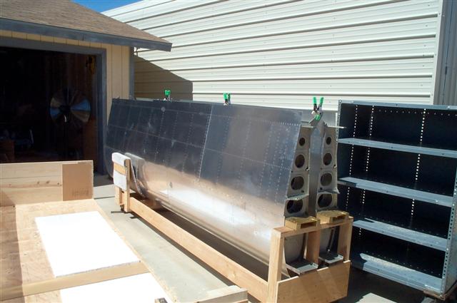

Posted: Fri Mar 30, 2007 9:56 pm Post subject: QB Wings |
Dave,
I had my QB Wings & Fuselage delivered by Tony Partain and they were not scheduled to be crated but the wings still arrived in a box. Don't know why.
Here are a couple of pics in case yours come this way also.
Kevin
40494
tail/empennage
[img]cid:007501c77359$2edff020$6401a8c0(at)KevinPam[/img]
[img]cid:007601c77359$2edff020$6401a8c0(at)KevinPam[/img]
The cradles were built from the commonly referenced design:
[img]cid:007701c77359$2edff020$6401a8c0(at)KevinPam[/img]
