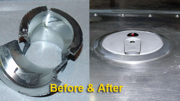

I'm posting this in the hope that others may be spared the problem that I faced with my fuel tank filler. About two months ago I installed capacitance type fuel level sensors in my 15 gallon ZAC made tanks. Deciding it would be a good idea to test for leaks I put about 5 gallons of fuel in each one, screwed the filler neck in by hand, installed the cap and set them aside for a couple of weeks. There were no leaks and after I drained the fuel out I went to remove the filler neck. The left tank came apart ok but the neck in the right one moved about half a turn and stuck. I and an A & P mechanic friend tried everything we could think of but in the end had to carefully cut the filler neck out. It was almost like the threads had welded together, even though I had used oil on them before installing. For what it was worth, I had noticed a couple of spots that turned a little harder when I screwed it in.
I contacted ZAC and they informed me that they would put me on the list to borrow the "big tap" to clean the tank flange's threads out. It was a few weeks before it was my turn but when it came this week I used it successfully to clean up the threads in both tanks. When finished, the new neck (almost a $70 part) screwed in and out very easily.
Today I installed it using a thread sealant and it when on very nicely. I would recommend to anyone that if your filler does not turn in easily that you may want to clean up the threads before trying to install. I've heard of other builders that have had similar problems of freezing threads and it can be costly in time and money to repair.

| Filler neck after removal - new filler successfully installed! |

I had a similiar problem and solved it by making a tool out of delrin that fit the filler neck and was large enough so I could apply the required torque to remove the filler neck.

I carved a piece of 2 x 4 to conform to the inner shape of the filler neck so that I could put some leverage on it. The wood splintered before the neck moved. I stopped there because I was afraid of damaging the threads in the welded flange which would have really been a pain.
The threads are small and fairly soft and I guess the fact that there is a waiting list for the tap indicates it is not an uncommon problem.

I was one of the builders that used the ZAC tap and countersink kit. I got the job done but it was not easy.
I used delrin (a machinable plastic) for extracting the filler neck. It will never splinter, however it is expensive, it was a machine shop discard so it didn't cost me anything. I think if you made it of aluminum or steel it would work if you made it under size and wraped it with many turns of duct tape.
I don't think you could damage the threads if slowly applied the torque.

I made my "stuck neck removal tool" from steel with a two foot handle. I wrapped several layers of duct tape around the point where it engaged the fitting. The fitting then came out easily but it did make a couple of small indentions inside the neck. The indentions were easy to clean up using a pattern file. Then I wore out two Dremel wire wheels cleaning the threads. After that they screwed back in by hand using a piece of 1/4 inch plywood to turn them.

I had trouble getting one out before I had them installed in the wing. I put some 3-in-1 oil around the threads and let it seep in. Still took some real doing at first, but then it got going and came right out. (Probably not helpful if it is already installed because you wouldn't have access to the threads, but I'm not sure what stage the OP is at!)

I had the same problem but called Roger before it was to late. I did have to
buy a new cap because i roughed it up pretty good removing it. The tap did
the job, I can now remove the caps with my hand using a towel to prevent
slippage.
