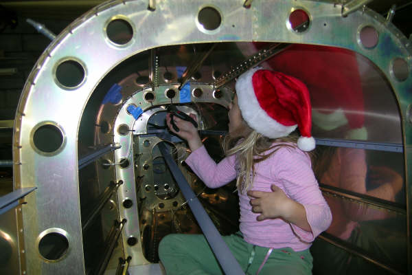

Thanks for everyones input. I would like to know what this paste is that
needs to be placed between the lug and the aluminum cooper wire of the fat
wire.
As for the aluminum wire being brittle and not being able to handle fatique,
I question where all the fatigue will be coming from in my installation of
the cable.
This fat wire is quite interesting in that as you bend it one can feel all
the individual wires moving over one another. It is quite flexible. As I
said, it is also quite light. I have used #2 welding cable on an automobile
starter motor which I made into a high launch winch for launching Large RC
gliders. That stuff is quite inflexible and is very, much, more, heavy.
Being that I am installing dual batteries with the Eggenfellner engine, I am
installing twice the amount of battery cable. Weight was a huge concern.
Please tell me about the paste which will keep my battery cable for catching
on fire like the light British destroyer did in the Faulklin Island
conflict. I wouldn't want my plane to fall out of the sky.
Here are some cable routing pics showing all the support to the cable. Huge
rubber grommet are used in stead of nylon snap bushings. Concern for
chaffing was very much considered.
