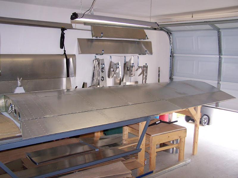

PostPosted: Sun Apr 15, 2007 1:24 pm    Post subject: Re: Dave's brake Reply with quote
When I need it out of the way, I just take the top plate off, leaving the rest of the brake attached to the table. I was able to build a wing on my table with the brake still in place. I didn't have room for a separate table.
If you intend to build my brake make sure to download the latest version of the plans from my website. I've included some tips for difficult bending situations. Feel free to email me if I you run into any problems.

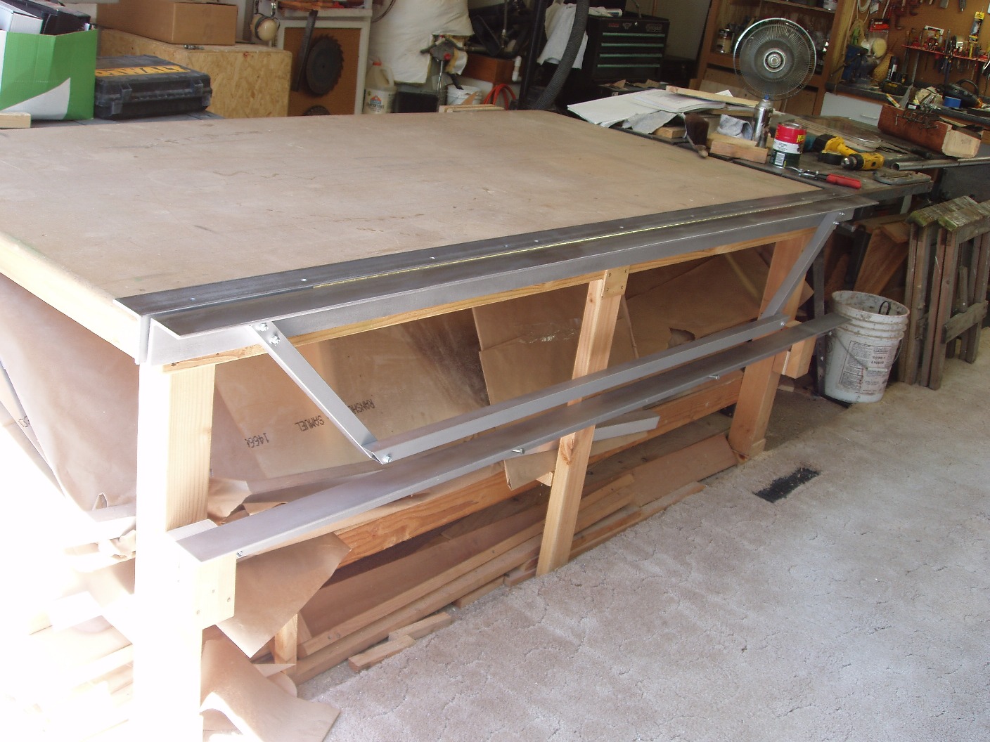

PostPosted: Sun Apr 15, 2007 3:13 pm    Post subject: Dave's brake Reply with quote
I find little or no interference at all. See attachment for an easy rack for the top piece.
