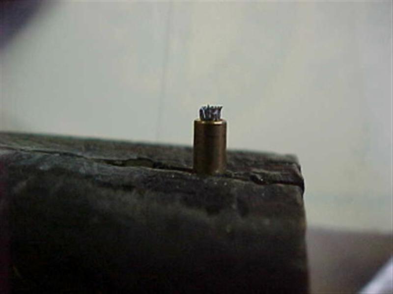

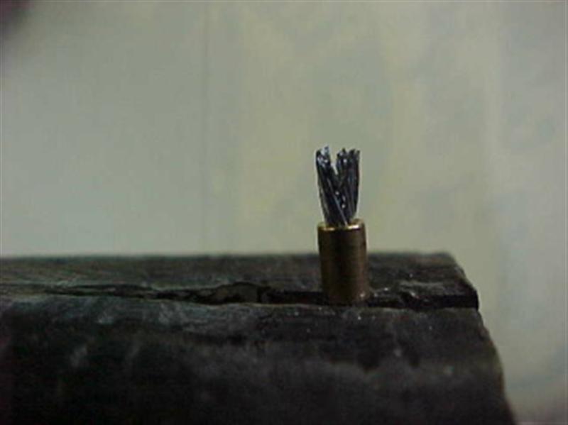

I disassembled the throttle splitter tube and confirmed that the cable
had indeed separated from the splitter assembly. The tiny brass ferrule
that is soldered to the end of the cable (this is what keeps it seated
in the splitter slider) had pulled off. I had soldered this ferrule on
during construction. It was my own workmanship that failed here,
nothing the fault of the Rotax.
After discussing the details with the local A&P at my airport, he
concluded that is was likely a cold solder that caused it to let loose.
His advice was to get a hotter soldering iron (or flame), tin the
braided strands well before flowing the solder in. Even if you are
using solder with flux in it, still apply flux to the braided cable
before you touch it with the solder.
It is fascinating to me how the mechanical failure of a part the size of
an uncooked grain of rice can put you on the ground.
And the 912ul fail-safe design of the carb setup got me home safe. I
love this little engine.
Lesson here is: Give appropriate attention to even the LITTLE details
during your building process. That tiny little brass ferrule needs to
be soldered correctly for it to do it's job.

CPS sells replacement brass ferrules, and here is how to guarantee the wire
will not pull through. One end of the ferrule is countersunk, the other is
square cut, apparently to make it easier to slip over the cable. Slip the
ferrule on the wire backwards so that the countersunk end is toward the end
of the cable. Now take an Xacto knife and rat tail the exposed end of the
cable. Pull the cable down into the ferrule a bit until it starts to bind,
if it is rat tailed really bad, it can't go through. You ought to have about
1/16" sticking out. Now solder it, the solder will lock the splayed rat
tailed ends in place in the countersink, make it solid so that it cannot
compress, and now you have a cable end that is too big to fit through the
countersunk end of the ferrule, in addition to the solder joint itself.

After I sent my post on this yesterday, remembered that I had done an article on this for our local EAA chapter newsletter, with some pictures. So here they are. I think the attachments will probably show up in reverse order, but you guys will figure it out.
Richard Pike
MKIII N420P (420ldPoops)
| Description: |
| This is what it ought to look like when it's done. |
| Filesize: |
21.32 KB |

| Description: |
| With the swedge resting on the edges of the vise, pull the cable back down as far as you can, and then solder it. Make sure that the swedge and the cable are both clean and ready to take solder. |
| Filesize: |
23.82 KB |
| Viewed: |
514 Time(s) |
