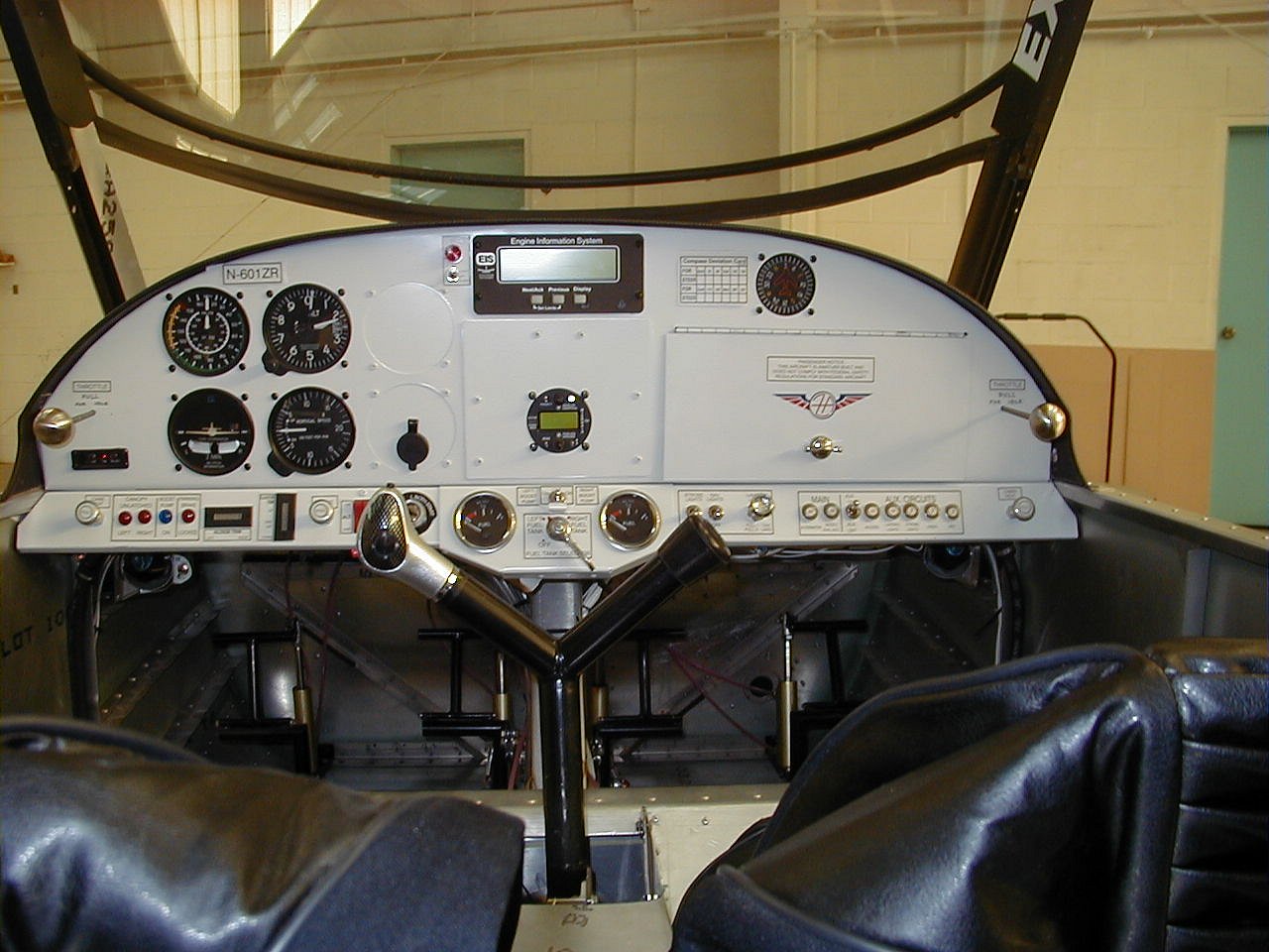

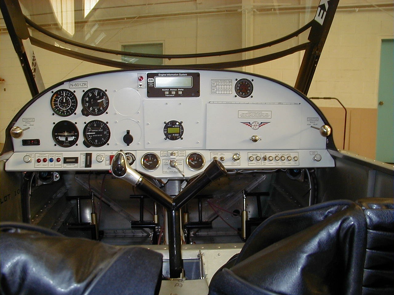

rickpitcher
Joined: 27 Feb 2007
Posts: 76
PostPosted: Tue Apr 24, 2007 6:54 am    Post subject: Re: stick grips Reply with quote
rosestar(at)sonic.net wrote:
Has anyone made their own stick grips? I have been "shopping" and many
of the commercial brands seem expensive. Has anyone made some out of
wood, aluminum, leather, or bicycle handlebar tape? I have flown
Zodiacs with the Ray Allen G205 and the Ray Allen G3. The foams look to
wear quickly and plastics get very sweaty on hot days. I am looking for
an alternative. Any ideas?
Brad DeMeo
Zodiac XL N601BD
I used the Ray Allen "hat switch" for trim control. Yes, it requires a relay to handle the load requirements of the motor, all of the switches that I looked at require a relay.
I mounted it inside a plastic gearshift knob available at Pep Boys. I added 2 pushbuttons to the assembly: a red one on the thumb side to transmit and a black one on top to toggle radio freq's . I'll attach a picture, you can see the 3 switches on the stick and the position indicators just to the left on the panel. http://www.lightflyers.com/zpanel.jpg
Rick
