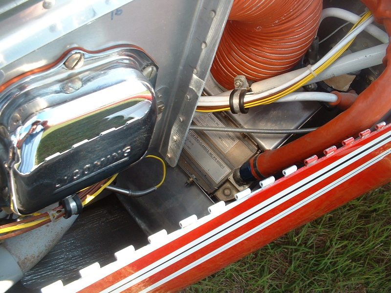

Heres a mod I saw at Sun N fun to redirect the oil cooler air towards the aft opening in the cowl, if you look at the front of the oil cooler you will see a sheet metal curved part that takes the hot air off the cooler air and redirects it to the bottom of the cowl and out the opening...not sure if it helped, the builder seemed to think so. He indicated
that the ideal position for the cooler would be 90 degrees from the firewall, not just tilted down like the stock cooler box.

supported with some data and testing. Rick, the pic of the diverter
duct/shield was intriguing, I wonder if it really helps w/ cooling. I'm
not sure what the velocity of the air is exiting the oil cooler, but as
it hits the duct/shield I would expect some backpressure to be created
which might have an adverse effect on 'pulling' cooling air from the
oil cooler. It seems to me that the most optimum location for the oil
cooler would be 'in-line' with the intake and exit air, with some sort
of a 'venturi' downstream of the oil cooler to compensate for any
airflow loss that occurs through the oil cooler itself. Seems that the
more bends that are put into the path of the airflow, the more the
airflow is restricted and the less efficient it becomes. Fluid dynamics
is magic to me so any insight into this topic is educational.
