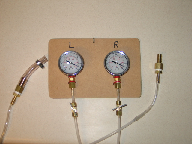

Roger Lee
Joined: 10 Jan 2006 Posts: 1464 Location: Tucson, Az.
Posted: Sat May 05, 2007 8:05 am Post subject: Re: Rotax 912 Idle Speed Setting |
Hi Hugh,
Carb sync tool picture

Roger Lee
Posted: Sat May 05, 2007 1:57 pm Post subject: Re: Rotax 912 Idle Speed Setting |
I don't particularlly like the tube type because you have to keep them oriented up and should be verticle and not leaned over. I like the dial type like in the picture. These can be any orientation and are easy to read. These are just gages you can pick up at an auto parts or online. The gages depending on how much you want to spend are $19-$30. Mine are liquid filled. The rest of the gage parts set is something you can pick up for about $10-$12 at your local hardware store. You do not need any special vacumm gages to do this carb sync. Something easy to use and read is the best.
Once you do a carb balance you will find it quite easy from then on. Just remember that the gage with the highest vacumm is the carb getting the least fuel. If you need more rpm adjust the carb with the most vacumm which gives it more fuel and the vacumm will reduce (i.e. vacumm is 12, adjust the carb to get more fuel and the vacumm goes down let's say to 10). If you need to decrease rpm then pick the carb with the least vacumm and raise its vacumm number by reducing the amount of fuel it gets. These adjustments are done by turning the Bowden cable. That's the main throttle cable that comes into the carb when you use your throttle. You need to use the idle stop screw and the vacumm gages to make sure your idle is set at it's correct rpm and the carbs are equal when they are at idle.
This doesn't tell you how to do it, but maybe a little insite as to what is going on when you look at the gages or your trying to set the idle when the gages are connected.
Again if you have any questions call me anytime.

4) With the balance tube disconnected during the pneumatic synch
process, pay attention only to the vaccuum readings and the idle speed.
The engine will seem rough even when the numbers are perfect but will
smooth out when the balance tube is reconnected. Rotax schools don't
always tell you that. Just make the numbers right and it will be silky
smooth with the balance tube reconnected.

identical to Hugh's.
3) I've never seen a Rotax 912 series engine idle REALLY smoothly
without the balance tube connected. This includes the CT with Rotax
912ULS at Lockwood being balanced by the instructor Dean Vogel on April
14th of this year. It includes our Allegro w/ 912UL. It includes the
Diamond Katana w/ 912F. It includes my old Titan Tornado with 912UL.
All of the above with vacuum gages exactly matched and idle at 1800
rpm. Incidentally, when setting the idle in the 1400-1500 rpm range and
the carbs are synchronized properly there is no difference in the
smoothness compared to 1800, at least not on the 80 hp engines.
Roughness is the thing we are trying to avoid. If it idles smoothly at
1450 rpm then there is no damage being done to the gearbox. At
Lockwood, Dean set the idle on the CT at 1800 rpm so I don't know how
it would have been at 1500 rpm or lower. I do know for absolute
certainty that the gages were reading identically, the rpm was 1800 and
without the balance tube the engine was running rougher than when the
balance tube was reconnected. The balance tube is an integral part of
the intake system, not a nice to have option. If it was not needed it
would not be there. Unless one has a dynamic balancer at hand, the
degree of roughness we are talking about is a subjective thing. Your
idea of smooth running may be different than mine. Unless we can
quantify our subjective assessments, then were are not going to get any
further in this part of the discussion.
