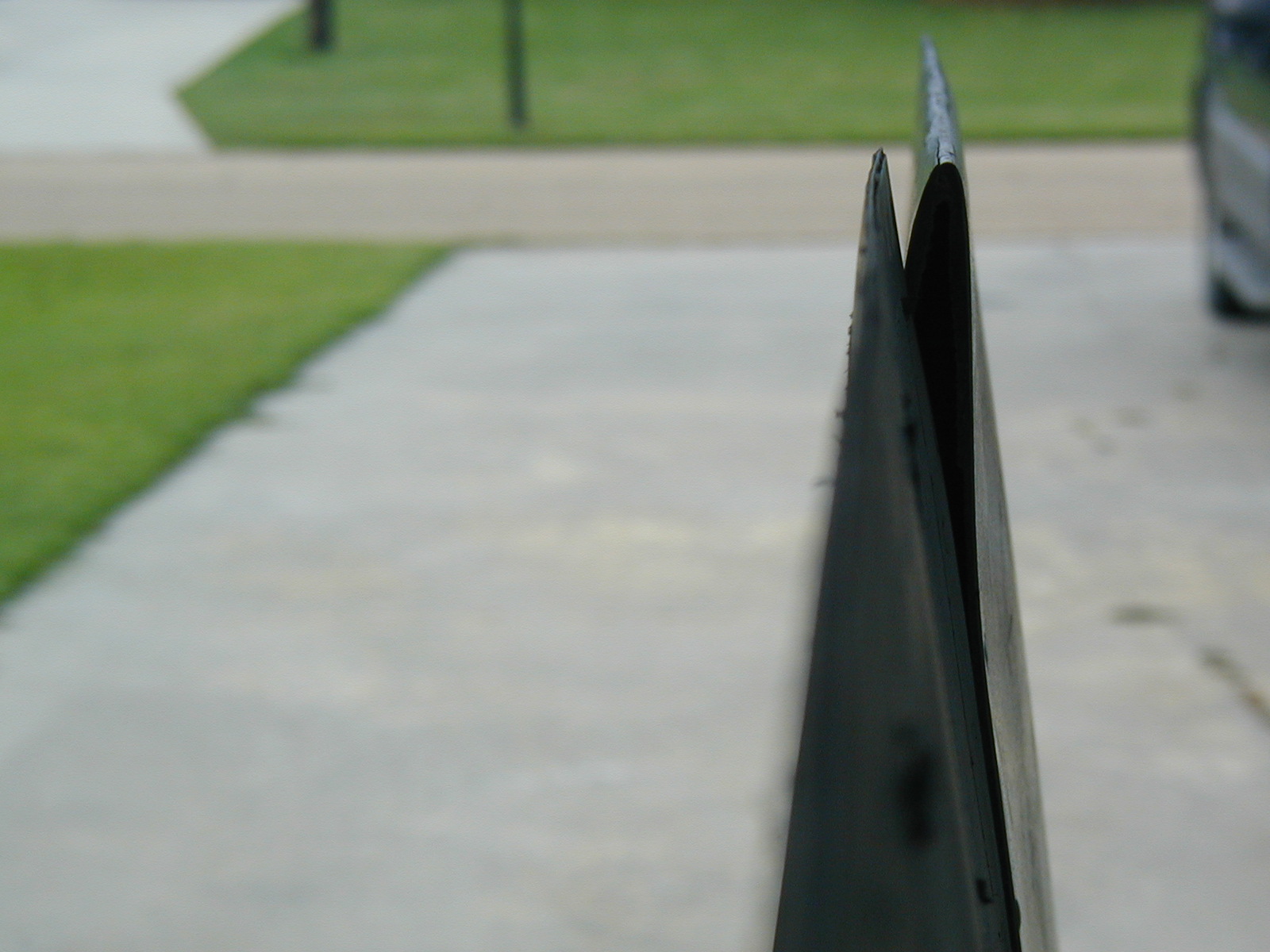

I am finishing up the wings so I can start to inventory the fuse kit and am having issues with the wingtips. The left wingtip is about 1/2 inch short but it is straight so I can just lay-up and sand down successive layers of glass. The right wingtip however is both 1/4 inch short and the trailing edge is about 3/8 inch below the rigged aileron and flap trailing edges. Hopefully I was successful at attaching the pictures below. Has anyone had this same issue and came up with a good way to fix it or any suggestions? Otherwise I will probably cut off the end aft of the tip rib and layup a new trailing edge. Thanks.

Eric,
It's difficult to see from the pics attached, and pictures can sometimes
be deceptive. In the picture that looks outboard it appears that the
aileron may have a twist in it and that might account for some of the
misalignment. ? :-\

That was my first thought as well. is the aileron twisted or the wing tip?

The following applies to your right (don't know about your left).
I just went through this last week.
Your holes are probably off just a tiny bit (mine were). My guess is about a half the diameter of the hole. It doesn't take much.
Here is what I did.
Epoxy the holes closed. Sounds like a lot of work but takes about 10 minutes. (one day to harden)
Temporarily install the tip rib (with tape or something). This really helps!
Now reinstall but this time be much more careful about alignment as you cleco and drill. I used strap clamps.
It will work out for you just fine. No easy fix.
Good luck.

The trailing edge of your wingtip can easily ride too high or too low if you
don't align it correctly before you drill the holes. Since the fiberglass
is not very thick and is thus not super-rigid, it can actually "twist"
around the radius of the leading edge, which will pull the trailing edge
either up or down accordingly. At least this is my experience. I have
usually seen that the tip is longer than needed, not shorter, but this could
easily be a modification of the mold or a different in the lay-up of the
glass. I agree that you should make sure your flap and aileron don't have a
twist (more likely in the flap), but the tip can run high or low depending
on how it is installed, independent of the aileron/flap rigging.
If you see that the wingtip is not right, then you may want to either
replace it or could probably find a way to re-glass your holes and redo
them. I personally like the hinge installation format as it makes it much
easier to install and remove as compared to 60+ screws, IMHO. Let me know
if this installation interests you and you can probably salvage the wingtip
if this even applies.

Dave, I will try to align the rib again. The pics are deceiving a bit. I never proclaimed to be a photographer. The aileron is straight as an arrow, picture is a bit off center. A twisted aileron would have gone into the scrap metal pile. I really had to wrestle with the wingtip to get it as close as it is. It has a real good twist to it. I will keep trying to reset it and see what happens.

Has anyone suggested heating the tip (heat gun) and pressuring it into
alignment until it cools?
