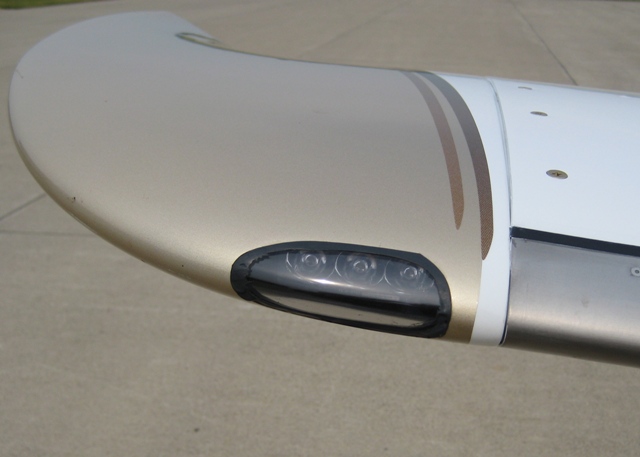

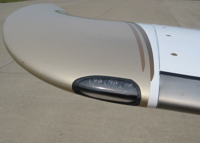

PostPosted: Wed Jun 06, 2007 5:09 am    Post subject: wig wag HID lights Reply with quote
[quote] --
 Filesize:  77.96 KB
 Viewed:  772 Time(s)
