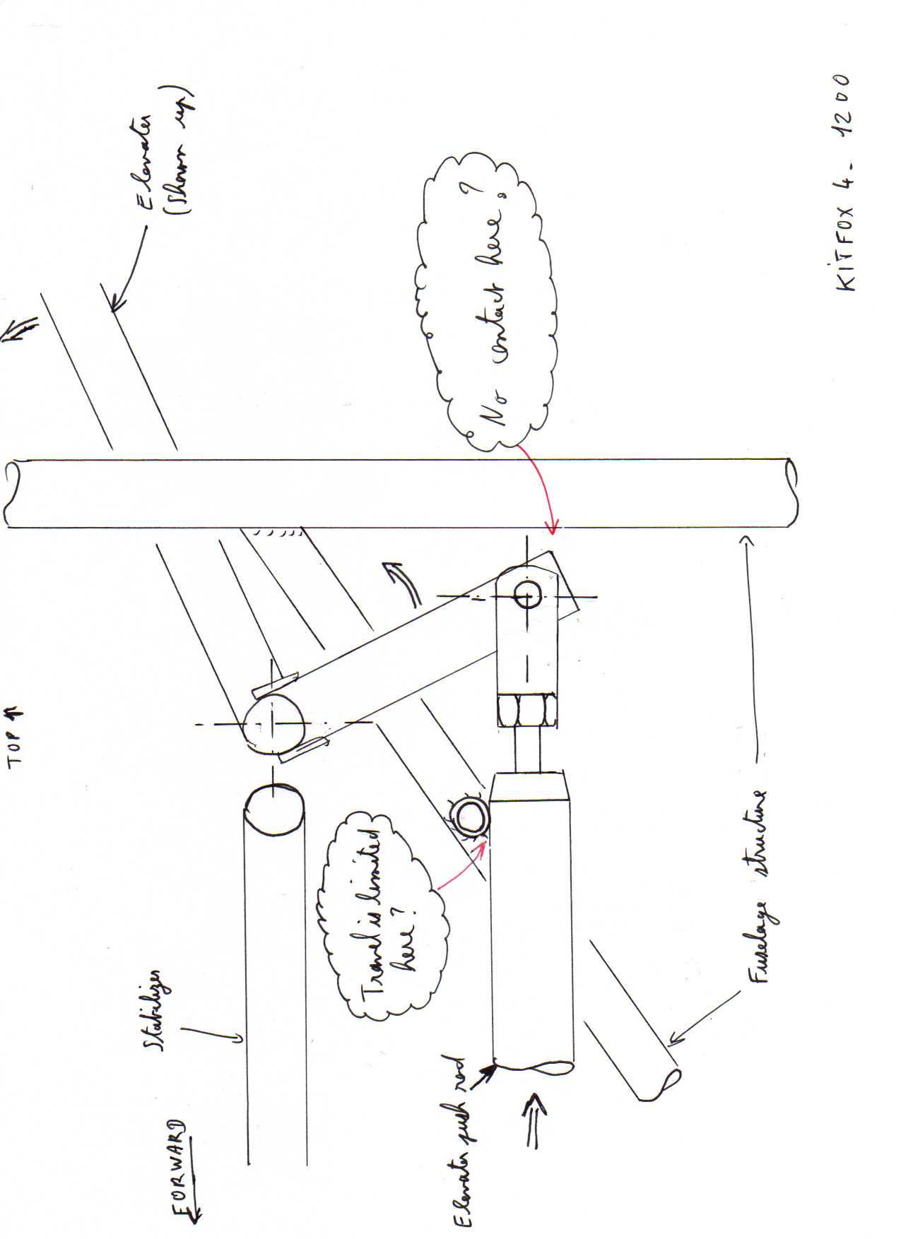

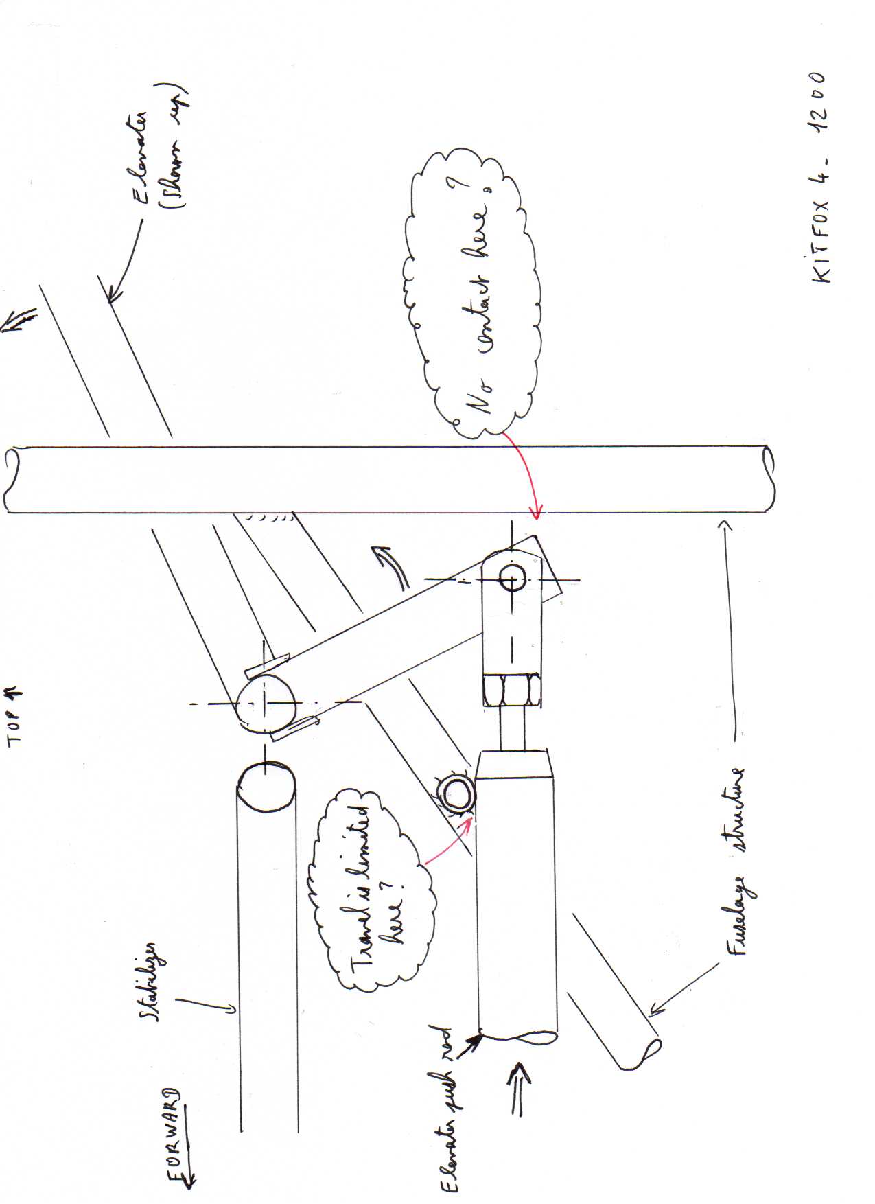

The manual of the Kitfox Classic IV says up +29° down -24° for the elevator.
One mine, the upward travel stopped when the push/pull rod hit the little transverse tube normally used to stop downward travel. (See the attached skecth). I checked with John McBean (Kitfoxaircraft) who confirmed that the upward travel normally stops against the rear vertical.
I built a little part fixed on the lever of the elevator that now hits the rear vertical of the fuselage.
At the end, I have a travel of ~35° up, just what I need for 3 points landing (and I sealed the elevator / stab gap). Downward travel is about 25°, but of course I never had to use it completely.
Maybe this can help.
