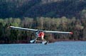

Attach either side of the rudder and bend the trailing edge slightly to the left.... I know it sounds like leaning into a left hook but that's it. Start with a slight bend and increase until you are comfortable with the results. If you fly low and slow you may need more tab input (bend) if you fly at the upper end of the envelope than you will use less.
[img]cid:753555020(at)15062007-0A1F[/img]
