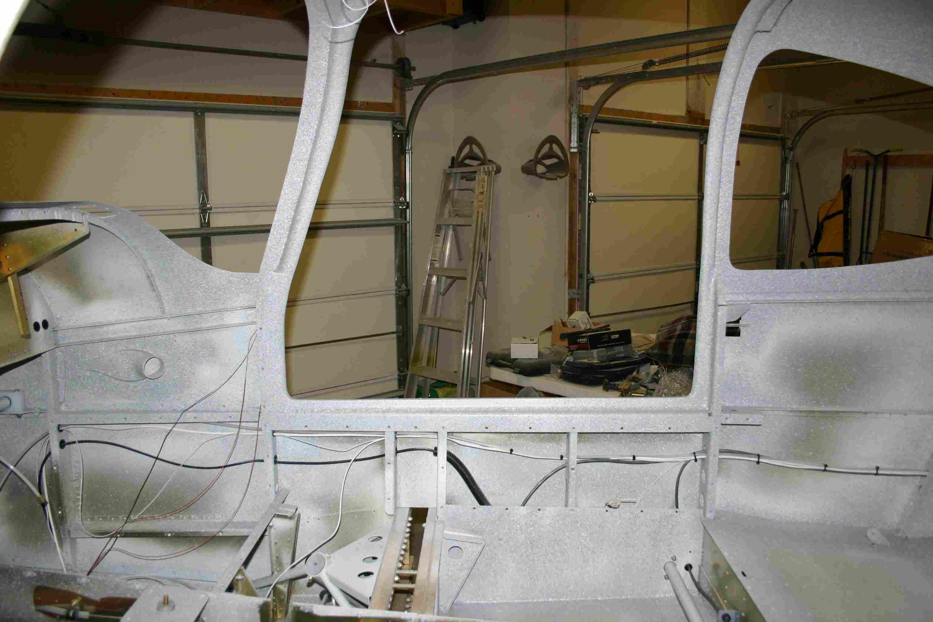

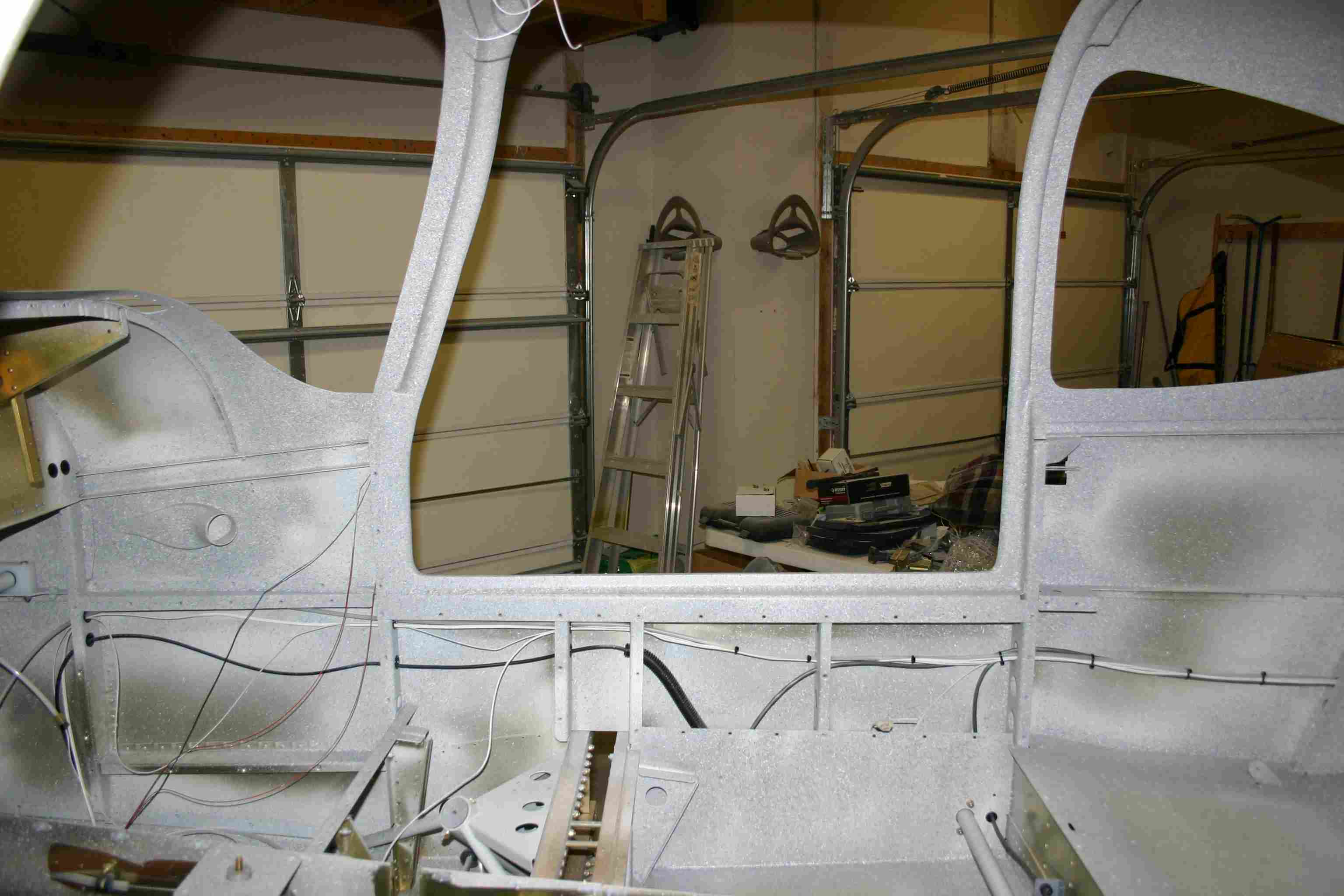

Ray.R.Doerr(at)sprint.com Guest
Posted: Mon Feb 13, 2006 1:15 pm Post subject: Overhead Lights |
They aren’t the greatest but they are all I had with me at work. You can see the three wires coming out of the bottom by the front pillar on the passenger side. The wires run up on the inside to the center of the canopy and then I drilled a tiny hole for then to run into the foam which is in the top lid and then they come out the 1 ˝” holes I drilled on the inside top. I removed about ˝” of the foam and then glassed in the bottom again. This will allow the swivel eyeball to move freely.
Thank You
Ray Doerr
40250
