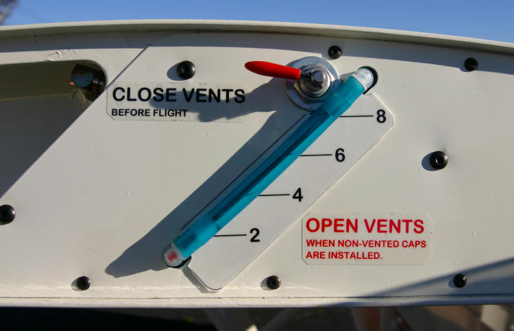

At 02:05 AM 6/15/2007, you wrote:
| Quote: | I have a problem that I can not tell how much fuel that I have on
board my Kitfox 2.I can not see how much fuel is in tanks.I have 2
wing tanks of 13gal total.from sitting in the pilot seat.during flight
Here's a picture of my wing root, looking outboard. Ignore the vent
garbage. You can probably install a sight tube like this after the
fact by epoxying a couple of 1/4" G-10 bosses to your tank wall,
drilling and tapping for 1/8 NPT, then installing nipples and elbows
and tubing. Make the bosses large, 1 1/4" OD; otherwise they fail
when you tap them. I put a WD-40 spray tube inside my sight tubes to
make it easier to see the fuel, but I won't next time as it was
unnecessary. You may not be able to get full range without removing
the tank, but even a reduced range is good since you can use your
rudder to slosh the fuel around and get some idea how much is in the
tank. I used tubing and elbows but some have reported elbow failures
and have switched to Murle William's bent tubes.
Guy Buchanan
San Diego, CA

| Quote: | From: Steve Shinabery [shinco(at)bright.net]
it would just B nice to see how much fuel is in fuel tanks.to B
safe.
What I do is to rock a bit the plane, to see the fuel level moving in the glass. Another nice feature is a low-fuel warning sensor on the top of the header tank. That should give you another 20 minutes flight. Lowell manufactures such low-level sensors.
Cheers,
Michel Verheughe
Norway
Kitfox 3 - Jabiru 2200
