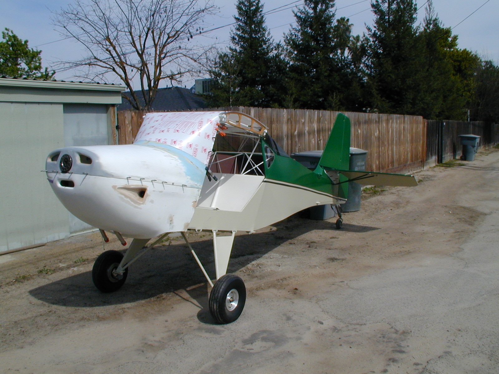

Here's some requested photos of my cowling with the Jabiru 2200, Model IV Kitfox

| Quote: | | Here's some requested photos of my cowling with the Jabiru 2200, Model IV Kitfox |
Beautiful cowling. Did you make it from scratch? Is that a big job? I've never been a big fan of the round cowl but I'm reluctant to spend much time or money on a cosmetic mods.

Luis, the cowling was supplied by Jabiru with the ffw kit that I purchased with the engine. The bottom cowl fits fine, but the upper cowl needed some modifications because it would not fit against the windshield. I had to remake the lip to match my configuration. I also lowered the instrument panel down and had to modifiy the panel dash. A lot of work but worth it in my opinion. I recieved lot of help from Dave Jalanti, who had already done the same thing. He can be contacted thru Jabiru USA web site.

| Quote: | The bottom cowl fits fine, but the upper cowl needed some
I like the cowl and your installation. I have a recommendation,
though. (Meaning, I wish I had done it.) If you haven't finished the
cowl I'd replace the fasteners along the sides and front with piano
hinge the way the RV guys do. Very clean, and very easy to remove the
cowl for inspection.

Thanks Guy for the recommendation, I will check the rv site so I see how they do it.
