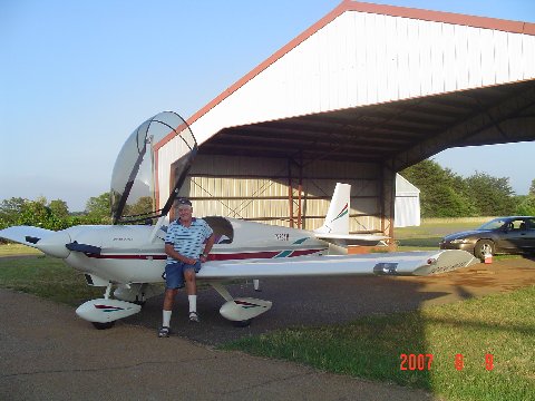

I have finished and flown my first 601 XL with a corvair and I am building 2 more. I found several flaws in Williams way of doing things but of course I am not William so anything I would want to contribute would be pointless. And no Craig that isn't me in the pic.

I'm not sure if someone is inferring I'm selling corvair engines but I'm not nor do I plan on it. I am however making my own parts and I haven't sold anything to anyone that I have made from Williams parts.
