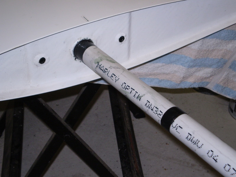

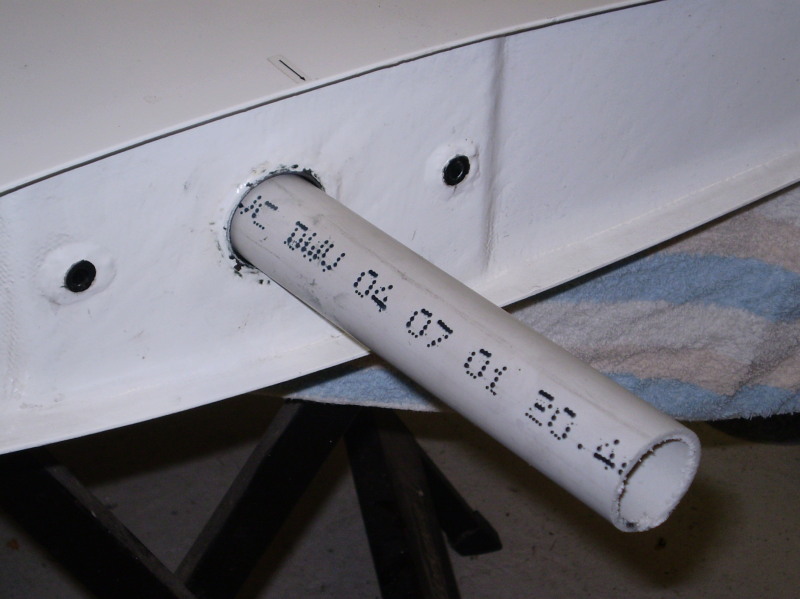

Hi Europa Builders from the deep cold south,
In regard to the recent tragic events and the PFA Airworthiness Information that eventuated from it, I decided to go ahead with a quick fix to the Tailplane pip-pin recess.
I am one of those 'non compliance' builders with regard to the recess, using, like many others I think, a circular plastic plumbers end fitting with a screw top end. See photo. Sent to me by a UK builder back in 1997!!!
This circular recess entered the tailplane touching TP 6 Sleeve with a screw top lid. I found, to my horror, that the position of the pip-pin head could just about move the distance of the TP12 bushes if the TP 6 outboard sleeve became loose. I did not have any bid over the TP 6 Sleeve as per the manual. It was necessary therefore to have a backup and not allow the head of the pip-pin to move at all restraining the tailplane from moving outwards.
I cut 2 x 16mm diameter aluminium tube to fit over the pip-pin head and glued those into position to the TP6 sleeve. I established those positions by wrapping insulating tape around the pip-pin head to increase their diameter to fit snugly into the tube and installing the pip-pin in the TP6 sleeve. I put grease on the insulating tape to stop gluing the pip-pin to the tube just in case. I then filled the surrounding area within the circular plastic fitting with epoxy plus flox up to the level of the aluminium tube holding the pip-pin.
On one of the tailplanes I had to use a PVC tube( increasing the diameter slightly by using black insulating tape, greased the tape,) and placed it in the TP4 hole to form a circular floor (boundary) up against the TP4 ceiling where the floor broke through the blue foam to stop flox running into the TP 4 cavity.
See photos to make better sense. I had another Europa builder visit today to check it out.He liked it. The tailplanes can now only move 1/2mm before the head comes up against the aluminium tube sides as a good backup.
Email me if you think you may do likewise and need some help.

I admit to trying to guess what Andy is thinking but my understanding is
that the object of the proposed exercise is to prevent the pip pin from
pulling through the tailplane structure and uncoupling the drive pins.
This is just a back up in case of failure of the TP6 bush bonding.
I was puzzled by the insistence on a "Minimum" area of BID lay up fore
and aft. However this will be more difficult to pull through the foam
core ( and the skin) than the cylindrical structure many of us have
built. The PFA amendment also insists on a flox corner with the skin, no
doubt for the same reason.
Open to correction?
Any comment Nev?
Graham

Tim,
I had planned to make something similar
but your plan & realization is much much
more sophisticated.
Can somebody there out see anything wrong in it ?!?!
If I did my tailplanes again, I should fit also one long
internal sleeve instead of two short ones. Rigging
would be not so irritating event...
Thank you, Raimo
