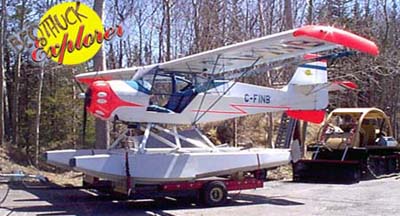

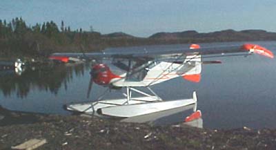

I've been following this thread with a bit of interest. What I get is simply, see and be seen.
Lowell had made a lot of practical observations in paint schemes. The use of the colour black was mentioned that it could cause the top of the wing to change shape (due to shrinkage) on a hot summer day.
My own plane is white with, would you believe it, navy blue and Day-glo orange stripes. The very first time I saw it I thought to myself if it ever goes down it will be easy to find even in snow. The guy who built the plane had a number of other aircraft over the years most of which had very similar paint schemes. One thing to keep in consideration if going with the Day-Glo is it will fade pretty quickly.
Thanks to whoever started the discussion on colours.
I'm going to include a couple of reduced pics of the plane which only flies day VFR.
[img]cid:400545812(at)01072007-29BF[/img]
[img]cid:400545812(at)01072007-29C6[/img]
Noel
