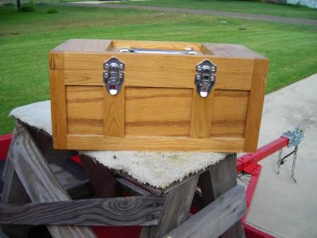

Wade,
I would not advise any builder to use the latching system from Zenith.
I have had nothing but trouble from mine since the airplane was new. First
the canopy would not latch so on the advice from some of the net members, I
raised the lower latch part by 1/8th inch using a shim under it. Then the
canopy would latch and now when it is latched and I am trying to open it
turning the knob on the left side of the canopy, it sticks. I plan to
eliminate the entire system and use latches like the ones on the box I have
enclosed a picture of. I would advise anyone building this aircraft to do
the same. This is the system being used on all KR aircraft and I know from
experence, it works fine and if you are scratch building it's a lot cheaper.
Tracy Stone
Harker Heights, Tx
ZodiacXL w/Jabiru 3300

PostPosted: Mon Jul 02, 2007 4:04 pm    Post subject: Canopy latching system Reply with quote
I will use hard wood blocks (Oak) to mount the latches onto on the inside.
One on each side. Both the uper and lower surface must be the same so that
the entire lach will fit right. When I get mine done, I will post a picture
so you can see how it's done.

PostPosted: Mon Jul 02, 2007 7:32 pm    Post subject: Canopy latching system Reply with quote
The canopy is only 1/8th inch thick and would be very easy to break in an emergency.
Tracy Stone

rstone4(at)hot.rr.com
PostPosted: Tue Jul 03, 2007 7:02 am    Post subject: Canopy latching system Reply with quote
Steve,
Then do so and put your ideas out on the net. This is how we come to the best way to do anything. If you have a better way, I would sure be interested. I have built both a KR-1 and KR-2 and now own a ZodiacXL with the Jabiru 3300 engine so I am not without experence but this does not mean my ideas cannot be improved on.
Tracy Stone
