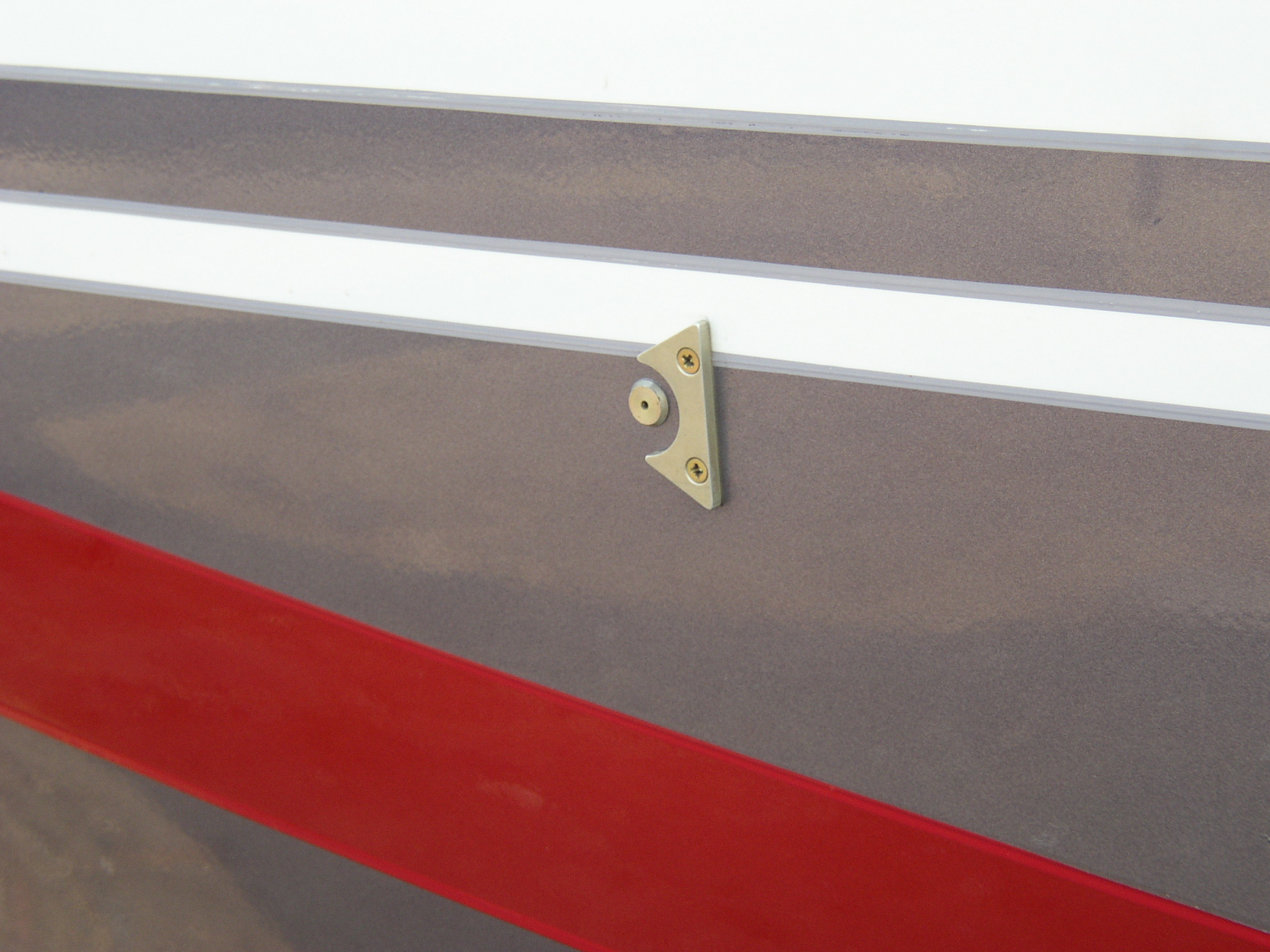

Before Dr. Carl Cadwell built the first Epic LT Kitbuilt Single Engine
Turbo-prop, he finished a beautiful Lancair (N25CL) that used the
boundary layer disrupter in the attached picture. This might help
clarify why the pickup port should Not be flush with the skin. Notice
the accent color pinstripe on the lower red to bring out the clarity.
One Shot - lettering paint was used.

wcurtis(at)nerv10.com
PostPosted: Thu Jul 05, 2007 6:33 pm    Post subject: More testing with OAT and Static Ports. Reply with quote
I don't know about boundary layer disruptor but these are stock S-Tec (Meggit) static ports used on their autopilots. I know this cause I have two of these on the tailcone sides of my Cardinal feeding the S-Tec 30 altitude hold. Ironically, the stock static ports on the Cardinal are flush and forward of the cabin door.
William
