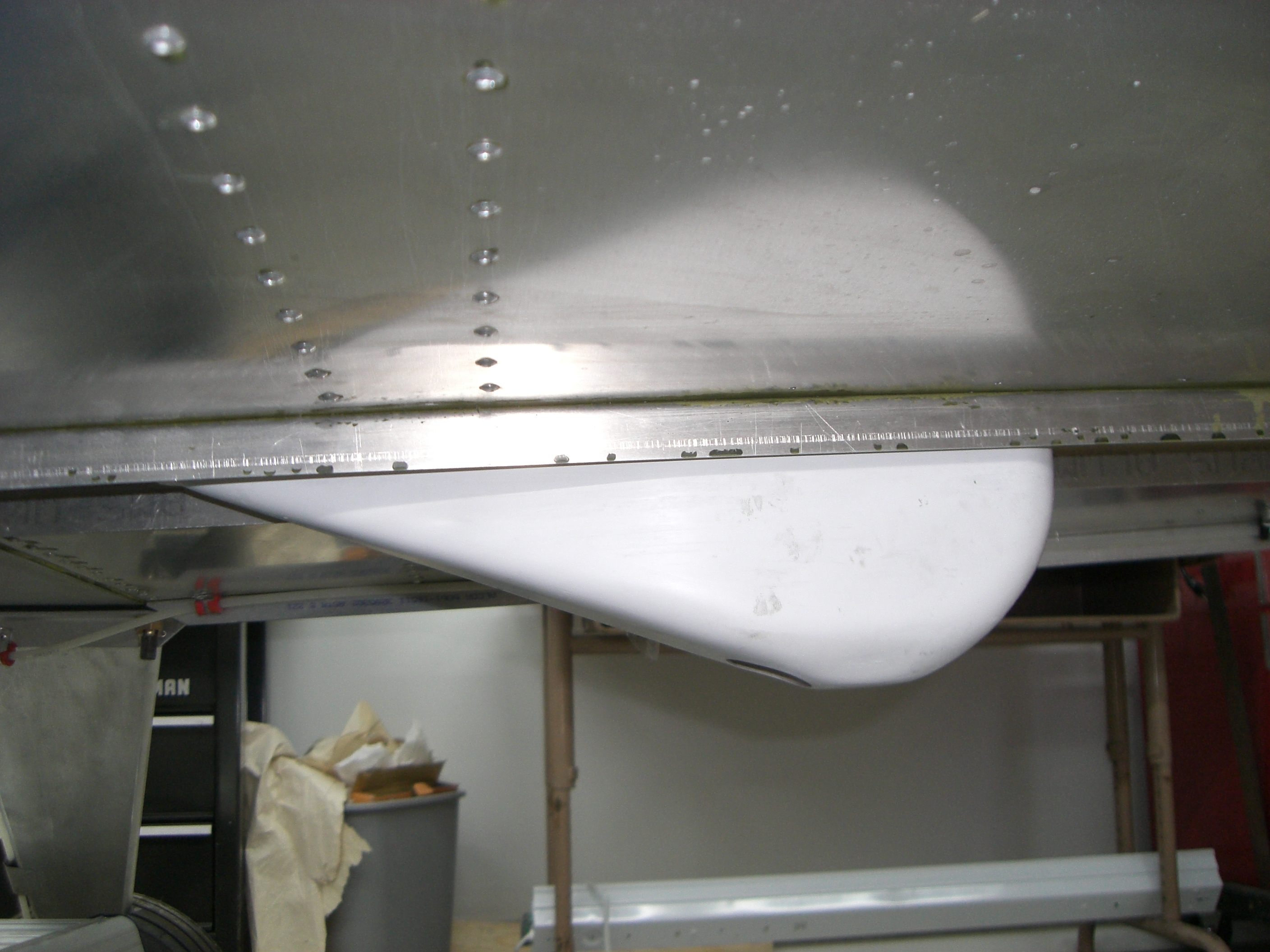

aprazer
Joined: 24 Nov 2006 Posts: 93 Location: Boise, Idaho
Posted: Sat Jul 07, 2007 7:33 am Post subject: Re: Moving the Fuel Selector Valve and Gascolator |
Howdy,
I was also concerned with that fragile gascolator hanging below the belly right behind the nose wheel on the 601XL. I fly the Idaho back country where the majority of the strips are gravel. I just could envision a rock flying up from the nose wheel and disabling the gascolator and once rotated -- engine dying due to fuel starvation. These airports are unforgiving and the mountains grow real fast -- so you have to place a lot of confidence in your equipment!
Attached (hopefully) are pictures of a fiberglass flaring that I designed. I hope that this will give you all an idea on how to protect the gascolator.
Mack
601XL/Jab3300 --90% finished with 90% of work still to be done
