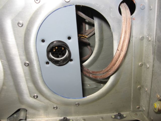

I put my CPC connectors on the wing inboard ribs - inserted a plate in the lightening hole. I did not put any connectors on the fuse side. I used a separate Molex for the strobe and located it well behind the other wires.
