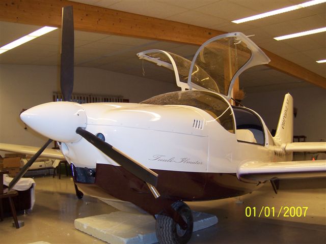

Rob,
I am not going to encourage anybody to paint their
Europa´s undersides any colour but white. I still well
remember Manual´s words: all the Europas must be white.
I still have to point out the energy of the sun is NOT
reflecting out of the black asphalt IMHO. That is why
it is hot when a sunny day. It absorbs allmost all the heat
energy and nothing is reflecting out. White surfaces are
cool because they are reflecting out much more.
So it could be more dangerous to keep it on the snow covered
surface while a sunny day (or on white sand or water w Europa floats!).
In Sweden there has been 10 years a wonderful full colour mid red Lancair 320
and no composite problems at all. Register # is SE-XOP (!). And like
we all know in South America (Columbia?) there is flying a total deep yellow Europa.
I think - with other colour as white - it is better to be even more careful.
Beauty is a good reason for some extra work and some sacrifice.
That is the fact all the women know. That is all.
"Keep your full matt black Europa in the hangar and fly only night time if you wanna be absolutely sure"
Raimo

robh(at)hyperion-ef.com Guest
Posted: Fri Jul 20, 2007 7:03 am Post subject: Europa colours |
Sorry Raimo, but this is dangerous thinking for those of us flying in warmer climes.
In my previous post I deliberately avoided getting into too much technical detail, and I used the word “reflected” where I should have used the technically correct term “emitted.”
First, you seem to misunderstand heat transfer. You are correct that the sun’s energy is not reflected from a black surface. However, a “black body” is not only a perfect absorber but also a perfect emitter, which is to say it may not be reflecting solar heating but it surely emits it. Park on a black surface and the solar energy absorbed by that surface will be re-radiated to the underside of the aircraft, and if that aircraft is any color but white it will absorb too much energy. Any material absorbing energy will increase in temperature. Sure, there will be some re-radiation from the dark aircraft structure but that is irrelevant because the epoxy-fiberglass will already have softened.
Second, the Lancair aircraft all use a different composite than Europa. Here’s how Lancair describes their composites on their web site http://www.lancair.com/Main/legacy.html ---
“Like every Lancair, the Legacy’s major airframe is constructed of advanced composite materials. Cured at 270 degrees Fahrenheit under vacuum pressure, these NASA tested, epoxy based composites are among the lightest, strongest, stiffest materials known.
The high-temperature, pre-impregnated carbon fiber and/or fiberglass systems combined with Nomex/honeycomb core materials are considered the supreme composite airframe materials of choice worldwide.”
Note that the Lancair’s composites are cured at a much higher temperature than the factory and we cure the Europa structural components. The “glass transition temperature” is approximately the cure temperature so softening of the composite does not begin until approximately T sub g is reached. For a detailed explanation to T sub g see http://en.wikipedia.org/wiki/Glass_transition_temperature For our purposes we can consider the glass transition temperature the softening temperature, above which the structure loses a significant portion of its strength.
Anyone contemplating painting a Europa any color other than white (including yellow) should review the chart in the Builders Manual, Figure 1, Colour-Temperature Relationship, on page 36-1 of the Europa XS Tri-Gear Manual, Issue 1, dated 30 May 1998.

raimo.toivio(at)rwm.fi Guest
Posted: Mon Jul 23, 2007 9:56 am Post subject: Europa colours |
Hi Rob
As I wrote
"I am not going to encourage anybody to paint their
remember Manual´s words: all the Europas must be white."
and
"I think - with other colour as white - it is better to be even more careful. "
and
Anyway - I called to my friend Jukka Paavolainen, who has build
and still flies his Lancair 320 OH-XJP. He said his Lancair is
just on ordinary glasfibre - epox system and definetely not baked
in high temparatures. Only the cowlings - because of the engine and
exhaust heat - has been made by more heat resistant phenolresins.
His Lancair kit is year model 1990 and so is my earlier example SE-XOP,
which is overall deepred and beautiful Swedish Lancair 320.
I believe newer models are as you described made by adanced composite materials.
You wrote
" Park on a black surface and the solar energy absorbed by that surface will be re-radiated to the underside of the aircraft, and if that aircraft is any color but white it will absorb too much energy. "
and I still think you are wrong. I am going to talk to one thermodynamist,
who works as a doctor in Tampere Univercity. Maybe he can make this
thing clear. I promise to come back and tell what he know. Also if I am wrong...
Fly it - do not melt it...
Raimo
Posted: Tue Jul 31, 2007 8:56 am Post subject: Europa colours |
Dear Jim,
as I have stated earlier
painting dark (underside only)
is only my decision and it is valid
here in Scandinavian, quite near
Polar Circle. When not in airborne,
it is in hangar - not under the sun.
I wish pure white colour makes you happy
in every climate in every temperature.
It must be like a prayer - with it you can
do what ever you like - w/o own judgement.
I have a headache - you have kicked my
head to the hot asshole.
Raimo, still the beauty is first of all
attached a pic of my "dark & dangerous" Europa

gregoryf.flyboy(at)comcas Guest
Posted: Tue Jul 31, 2007 10:51 am Post subject: Europa colours |
Raimo,
That sure is a beautiful looking bird, you must be proud. Up there near the polar circle, you might need that darkness to keep the belly from getting too cold!
Greg
