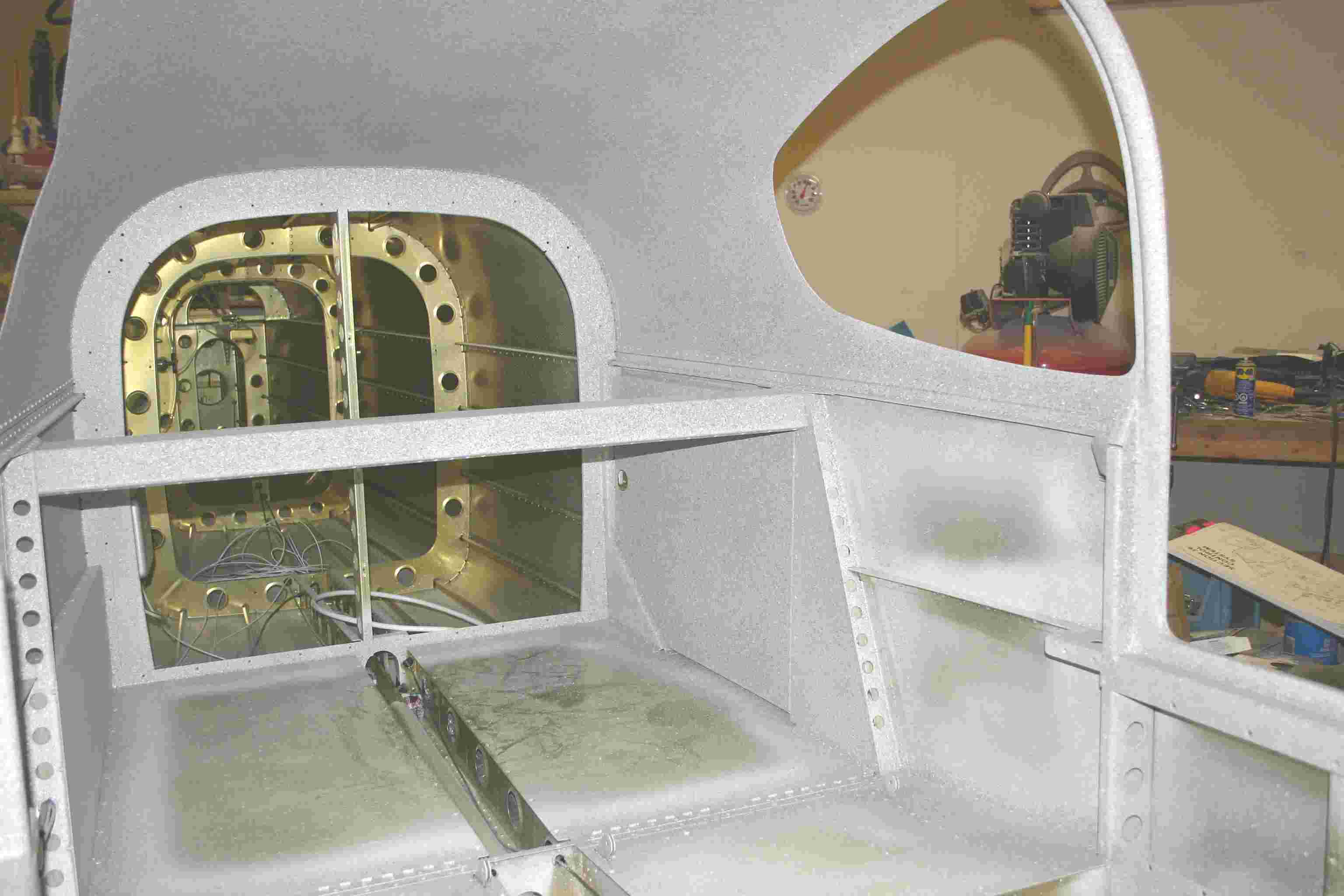

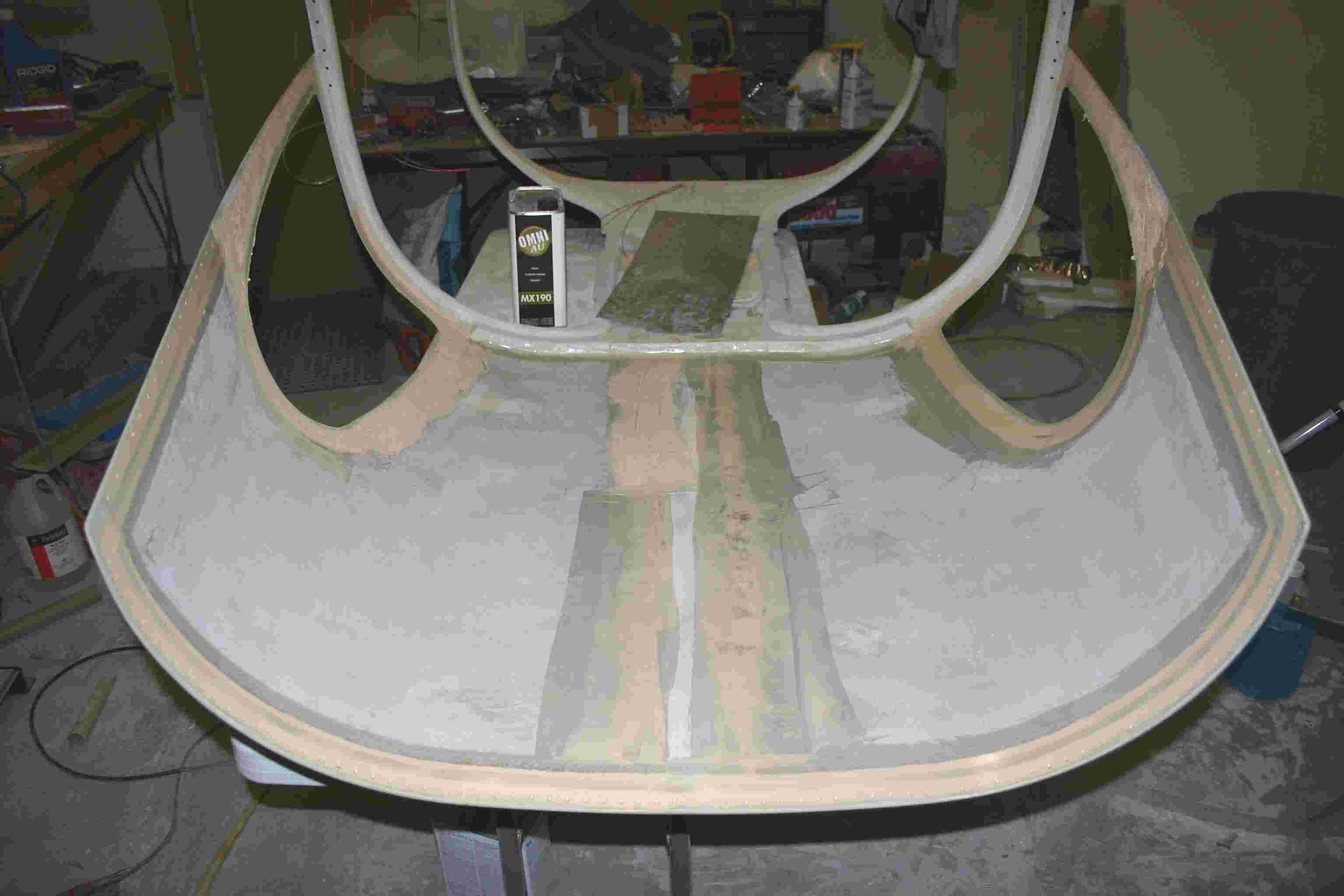

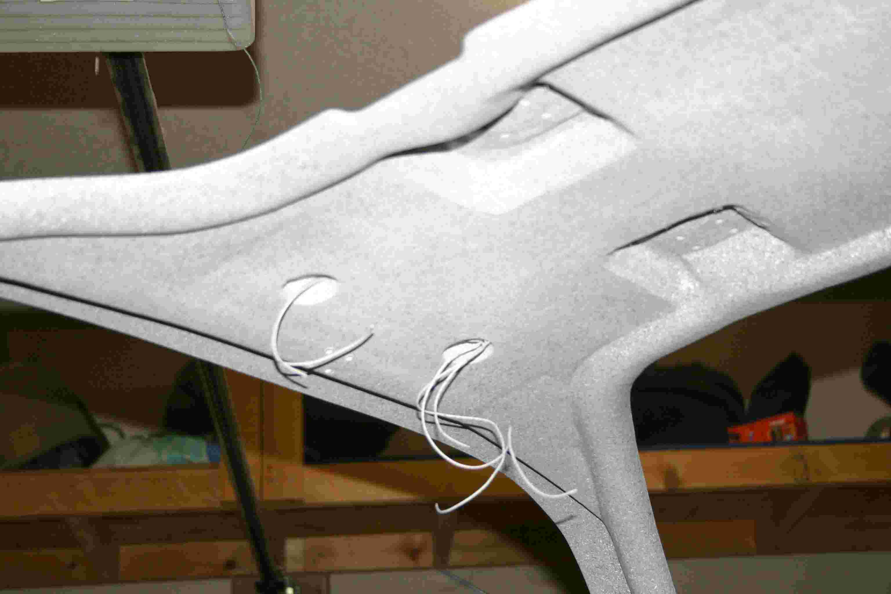

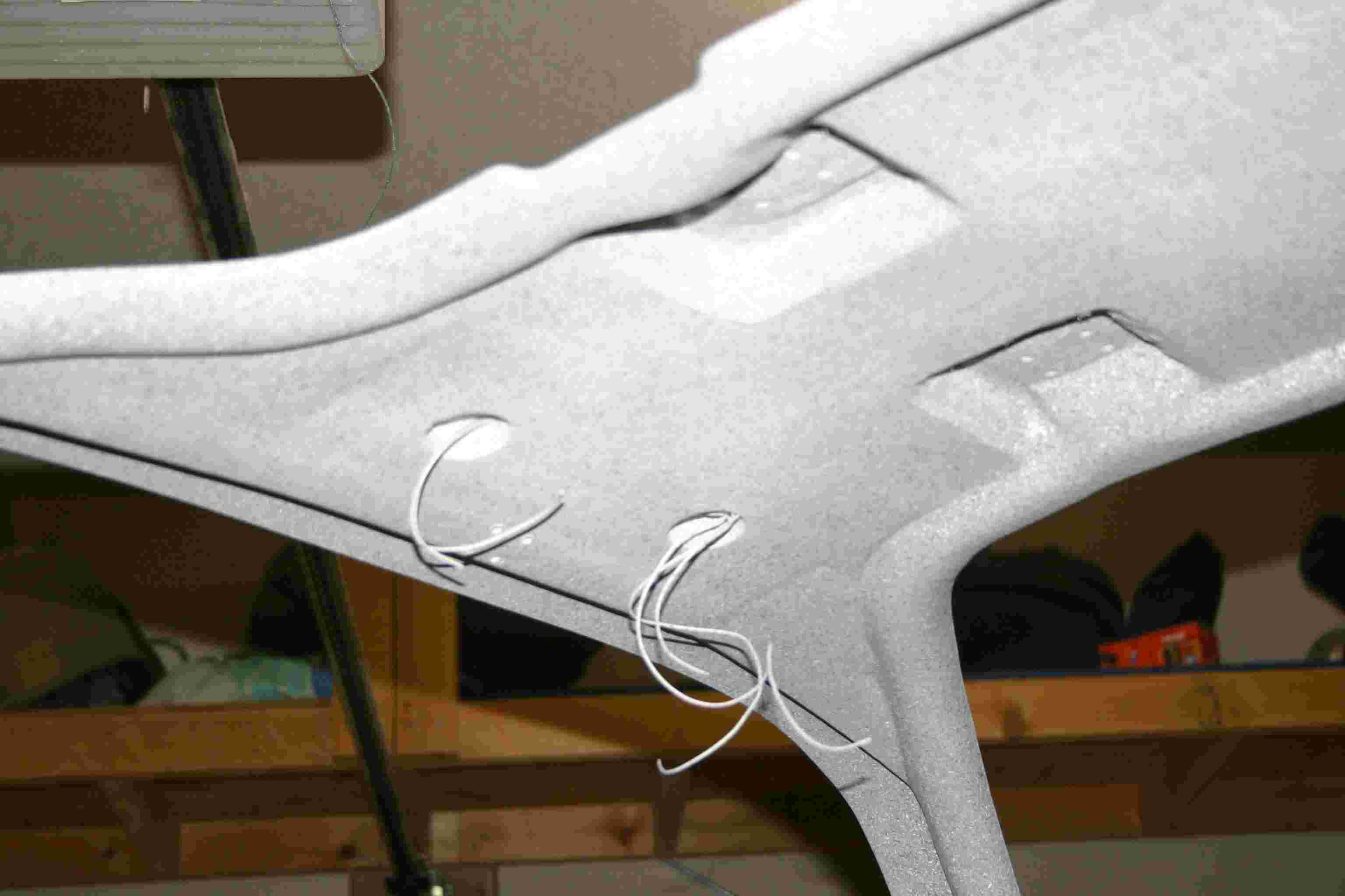

PostPosted: Thu Jul 26, 2007 10:20 am    Post subject: spraying UV Smoothprime Reply with quote
Here are some pictures of my top. You can see that I filled all the voids around the rear windows so it was all smooth and then I sprayed the Zolatone. Zolatone requires a large tip for your gun so the little balls of paint don't explode until the hit the surface being sprayed and not at the tip of the gun.
Thank You
